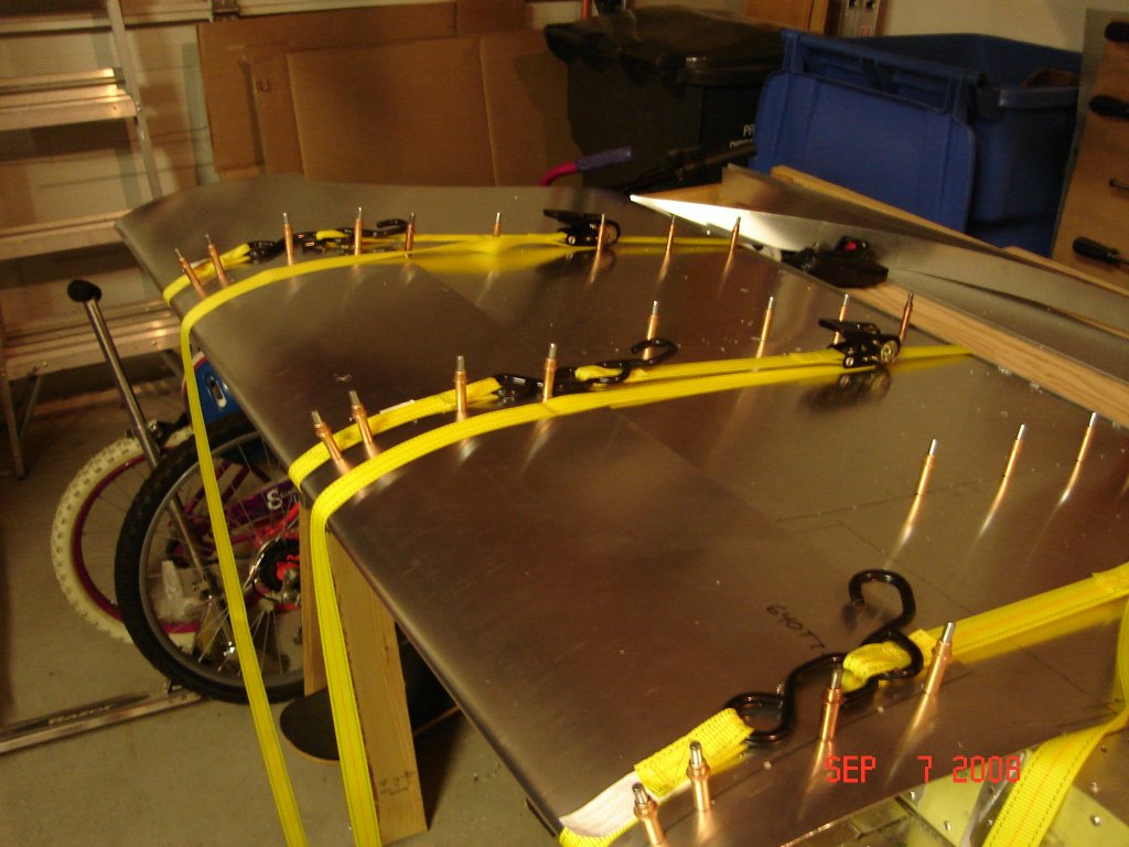

I drilled and clecoed the full assembly before doing any riveting (see attached picture).
I noticed that many of the pictures on the CD are from the assembly of their prototype and show parts being riveted before they should be or installed in the wrong sequence. The pictures should only be used as a reference to understand how the parts fit together. The IPL gives you the correct sequence; and even then, you need to be sure to read ahead and use some personal judgment on the best sequence to build your plane.
