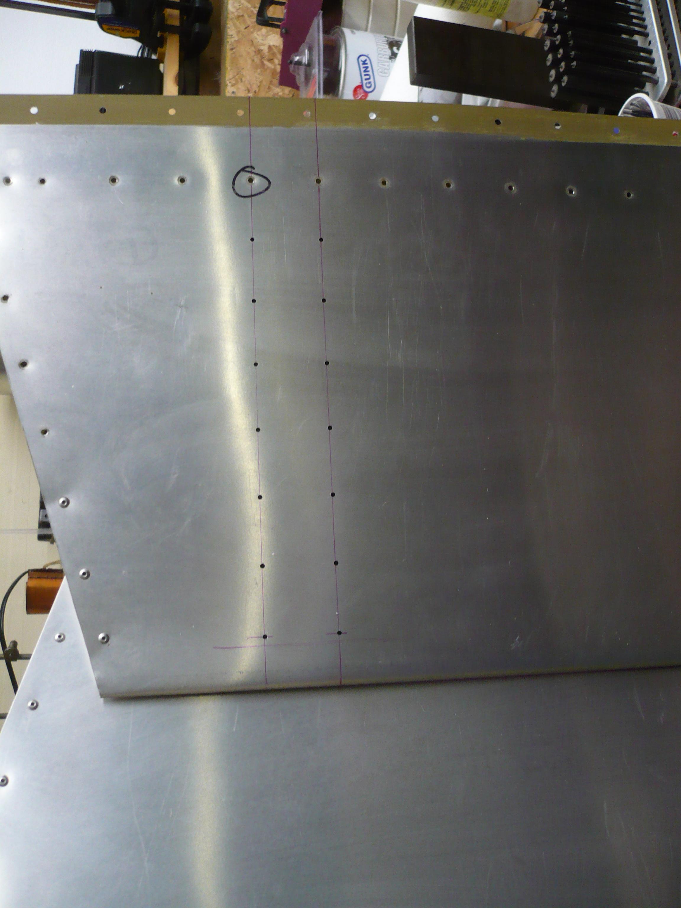

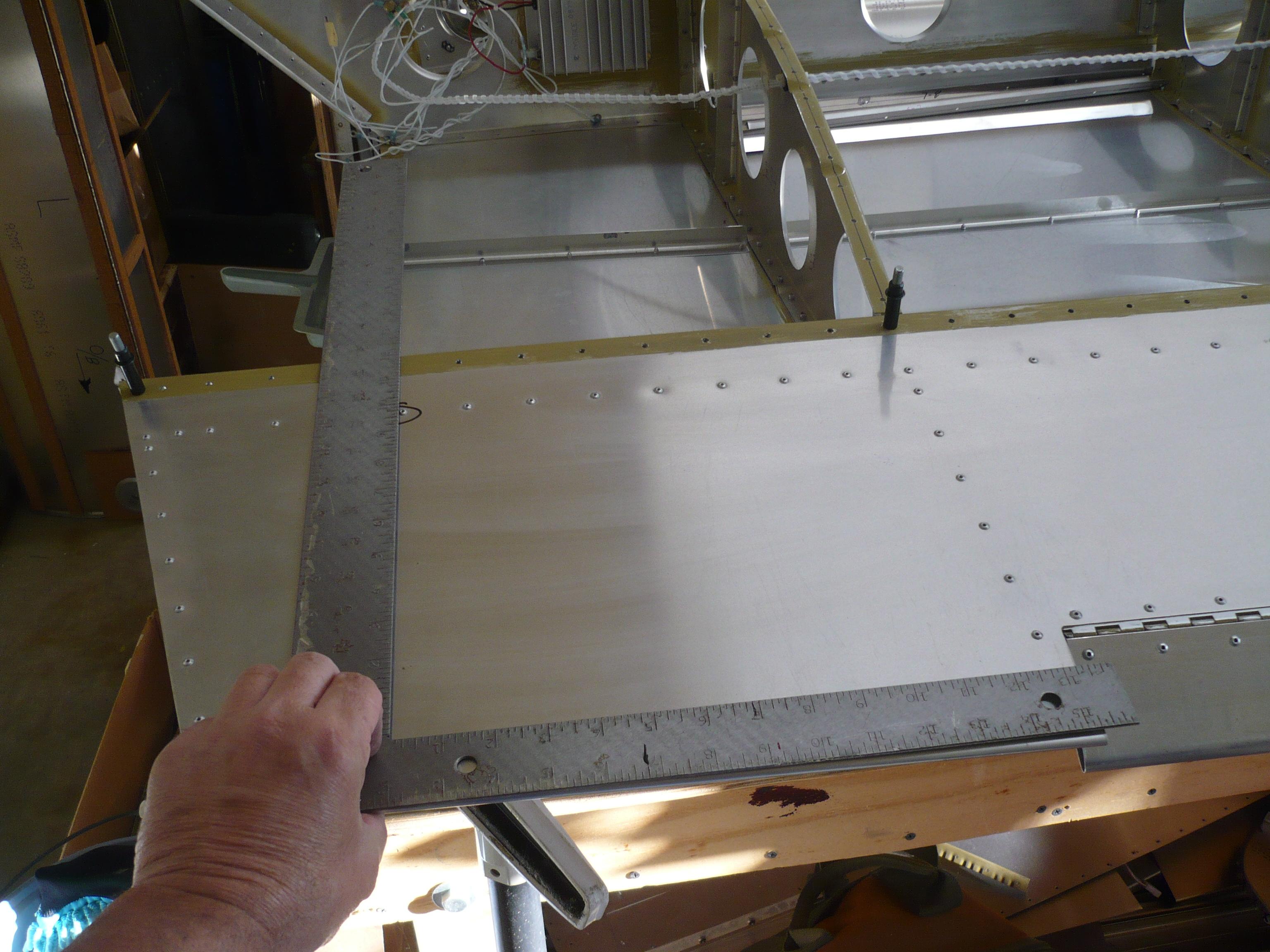

The one I just did I just made square to the hinge line and picked up two existing rivets for the new rib rivet lines. I checked clearance with a large carpenters square from the center of one rivet and wouldn't ya know, the next rivet was 40mm away, ( just perfect for the rib lines) . It was very easy to draw those lines around the aileron skin using a square. Once the lines were drawn just mark and drill the end holes, and rivet fan for the 5 rivets on the end, and 8 rivets top and bottom.

Top surface new rivet lines for the balance arm ribs

Using Square to determine where to put the ribs in the aileron
