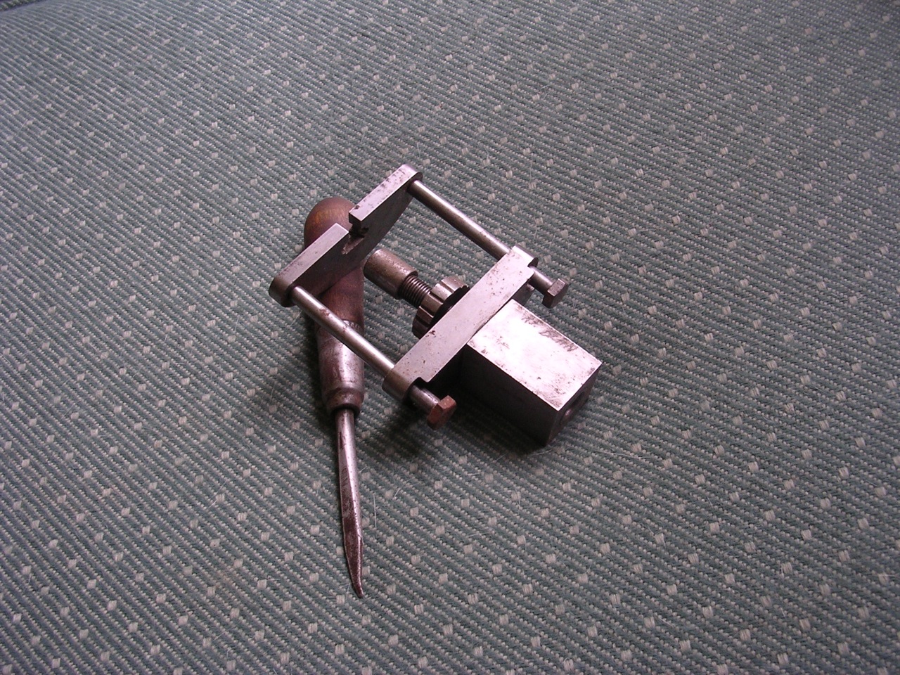

slyck(at)frontiernet.net
PostPosted: Sat Jun 19, 2010 9:33 am    Post subject: Help with elevator cable Reply with quote
<Does anyone, instead of swaging, use the old cable splicing technique per
http://thevintageaviator.co.nz/reference/cable-splicing ? I can recall in an earlier life as a young apprentice having to do it this way. Sure was a strong bond with virtually no chance of it coming loose. On the contrary, it held tighter under tension. Swaging would be much quicker but splicing looks better (subjective). Just curious.
David.>
At Northrop part of the course was to make this fixture (and the poking awl) by hand, using nothing but hacksaw, file, and hand die.
The thimble fit in the little base receiver and the block went in a vise. We then had to do one splice, also for a grade.
If you want to correctly restore an antique airplane this is the only way.
BB
(prefers swage)
