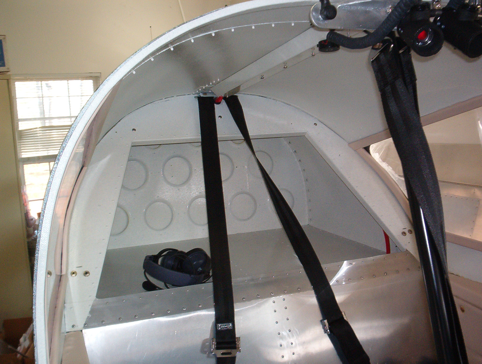

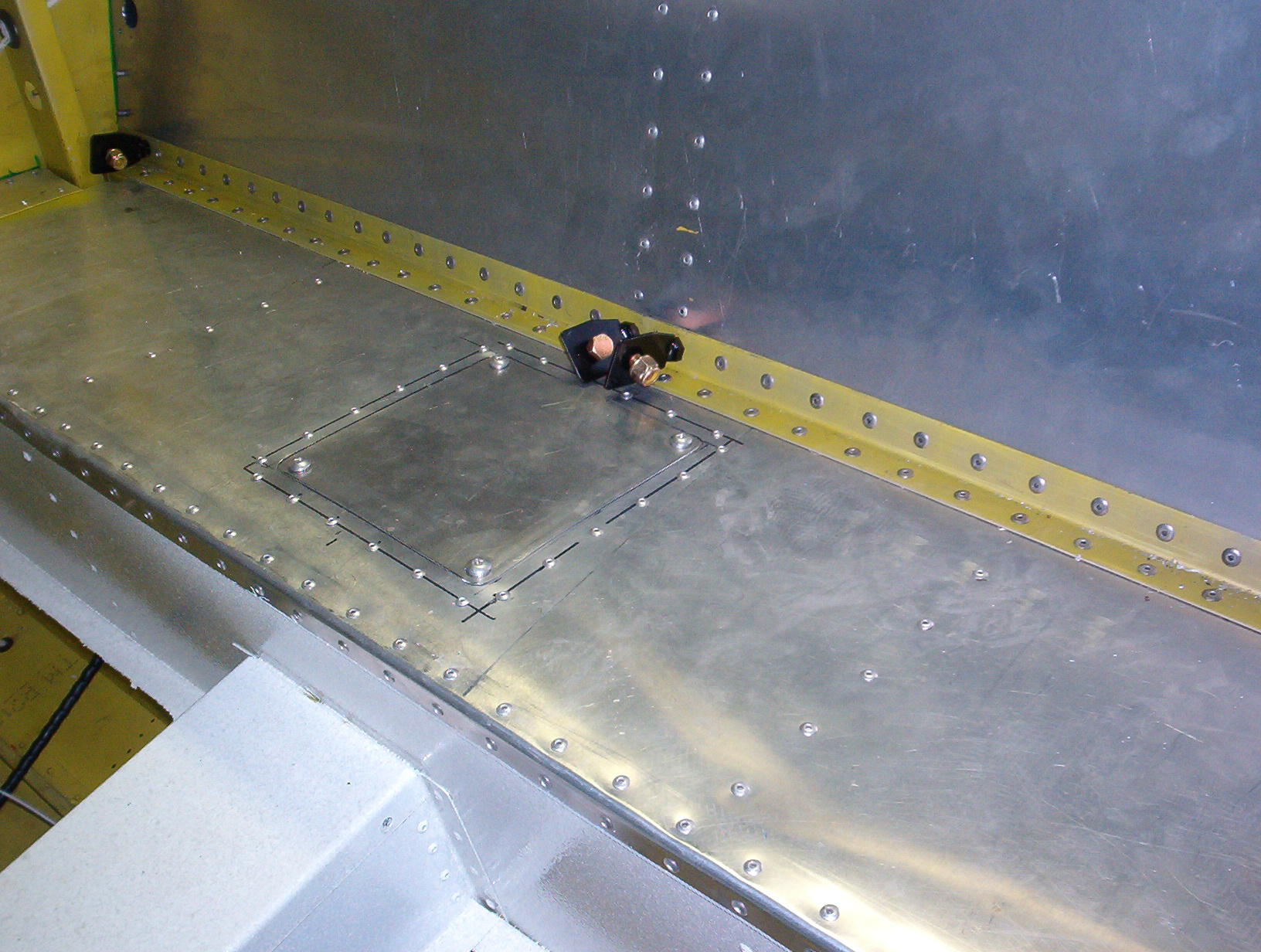

I don't have the plans with me, but here are a few photos of how I did mine. There is a single bracket in the top center where both shoulder belts attach. Sorry about the large size, I can't change it on this computer.

Lower Attachements
 Filesize:  837.63 KB
 Viewed:  9890 Time(s)
Upper Attachment
 Filesize:  776.57 KB

I had forgotten about the upper attach point for the shoulder strap. I was focused on the lap belt attachment points and finishing the rear seat.
Steve, from your picture I see that you have the four identical F40-11 seat attachment points as called out in the IPL. Apparently, the F42-4 outer seat belt attachment plates were added to the plans at a later date. I also wrote to Zenair, and Mathieu just wrote back that he will check the plans after Oshkosh.
