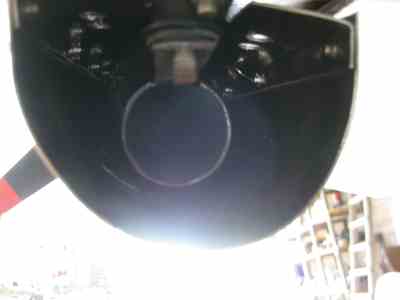

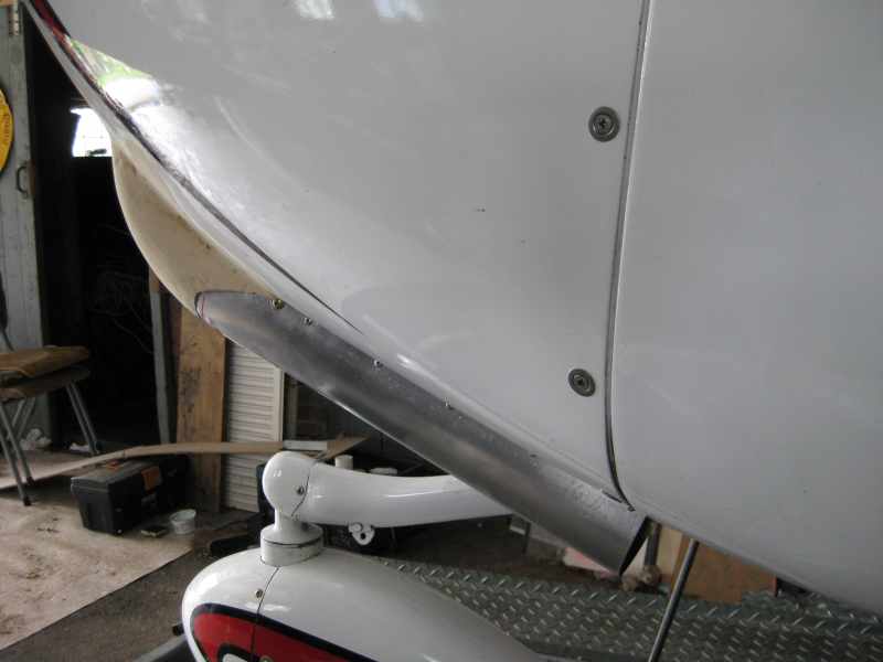

About the pictures.
Keep in mind that this is an experimental setup. I had to rework the
cowling anyway because of cooling modifications, so I decided that this
was the time to experiment with an exhaust augmentor. The setup is not
yet painted or anything.
The first thing you need is a new exhaust tube. A company specialized in
building stainless steel exhausts was willing to weld one on my
directions. The new exhaust was 200 grams heavier than the original one.
Then you need a duct, an enclosure. I make one of a sheet of aluminium,
bended with a 8 cm diameter, into a U-shape. The top of the U is closed
with an aluminium heat shield, allowing some space between the foot well
and the shield. Cool air is drawn through this space as well, to keep
the bottom of the foot well cool.
The exhaust should be shorter than this duct to generate the sucking
effect. I made it 5 cm shorter, but this was just guessing. The best
length can be found with experimentation, but is a bit cumbersome to do.
I noticed just a slight discolourisation at the end of the inside of the
duct, so obviously the exhaust fumes have expanded there just enough to
reach the duct. I think this means that this is about the optimum shape.
If the duct is discoloured over a longer distance, there is no vacuum
effect anymore in that area, if it doesn't touch the duct, some air
might even enter via the exit in opposite direction to fill up the void.
In front of the duct is a shape, attached to the cowling, to make a
smooth transition between the cowling and the exhaust augmentor. It is
not yet fully sanded, nor painted, but a rough representation about how
it is going to look like.
To protect the fuselage in the direct vincinity of the exhaust, I put a
small aluminium plate against the underside of the airplane, spaced
3mm's off the underside, to allow air to circulate between it. This
proves to work well.
As the Europa classic also exits the exhaust on the underside of the
airplane, I consider this as safe to do.
Test results:
1) The foot well doesn't run hot, not even with full power on the ground.
2) The aluminium duct feels hot over its entire length, despite the fact
that it is in the propeller stream and gets a lot of cooling. In my
opinion this can't be contributed to radiant heat alone, it means that
hot air from inside the cowling is rushing out via this duct.
Keep in mind that I have closed off the front 3 inch round inlets, so I
have no ram air. Instead, I have two naca ducts in the top cowling aimed
at the cylinders, but due to their location they are out of the
propeller wash. This means on the ground I have little airflow inside
the cowling. It appears that the augmenter is making up for this.
3) If I open up the coolant access door after a ground test session, it
normally feels like opening a furnace. This is no longer the case: it
feels relatively cold inside, but after a few seconds, suddenly hot air
exits the access door opening. Hot air starts to rise up. This might
indicate that as long as the engine is running, there is quite some
airflow through the cowling.
4) In flight I could not see an obvious increase in speed. This means
that if there is a speed difference, it is probably low. Unfortunately,
I have also changed the inlet of the radiator at the same time (this was
a failed attempt to get the two radiators in tandem working) and this
new setup is likely to have more drag. It could be that the augmentor is
making up for the drag penalty of the new radiator inlet. The latter I
will revert back to its original shape soon.
