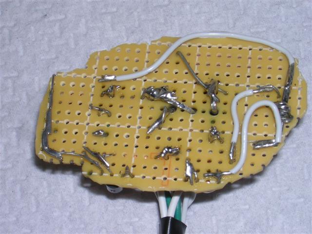

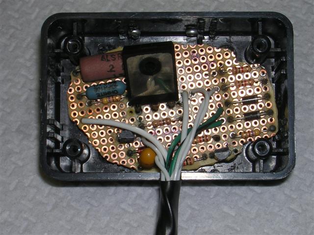

The components were assembled on a Radio Shack circuit board. I bought a Radio Shack Project Box to put it in, thinking (foolishly, as it turns out) that the board would fit their box. I had to chop the board down to fit, so my previously nice and neat circuit board now looks rather ugly, but it still works. I will put some pictures up on a website in the near future showing what I did.

Here are pictures of my IVO circuit. I soldered the parts to the 'wrong' side of the board so that I didn't have to worry about unintended connections on the back side. The board looked very nice before I had to chop it down to fit in the project box. I've also attached a PDF showing Bob's circuit design and the physical arrangement of parts and connections I developed. I should have gotten the project box up front, and I could have easily placed the components closer on the board. Oh well.
In the box
 Filesize:  63.71 KB
 Viewed:  5312 Time(s)
Connections side of board
 Filesize:  52.33 KB
