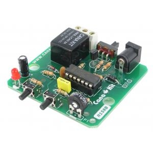

I have built a timer kit for my transfer fuel pump (CK158B from
CanaKit.com) that works as desired. The directions indicate that it
should be powered by 9 Vdc supply or a 12 Vdc 'regulated' supply. I my
electrically dependent plane, I will be using 2 AGM batteries powered by
2 alternators (55A from Geo Metro) converted to external Ford regulators.
I need to build a circuit to drop the 13 to 15 Volts to 9-12 volts,
so as to not zap the HEF4541BP timer IC or 9V relay coil. On my lab
supply, the ammeter doesn't register any perceptible current (it can
show as little as 0.1 amp) while the timer is running with the relay
energized, so I don't know the actual current draw of the timer.
Can you suggest a regulator circuit that will drop the extra 4-5 volts,
and keep the electronics from frying?

See: http://aeroelectric.com/Pictures/Schematics/Accessory_Regulator.pdf
This circuit can be built in a variety of 'sizes'
depending on your current demands. The LM317 is
good for up to 1.5A on a sufficient heat sink.
In your case, you probably don't need any heat
sink. Looking at the product you're integrating
into your airplane . . .
[img]cid:7.1.0.9.0.20100607085552.0200d548(at)aeroelectric.com.0[/img]
It appears that there would be room on the
bottom of the board to bond an LM317 right
to the ECB and wire the rest of the components
to it . . . also tacking them to the board
with E6000 to avoid vibration breakage of
the leads. Thus you modify the existing
assembly to run from the aircraft bus as
opposed to adding another black box to condition
power for this one accessory.

Hi Bob
Instead of the LM317 (which requires the use of tuning resistors), what about using an LM7809? It's almost identical to the LM319, but without the variable output option - it's preset to 9V. Also good for 1A, with adequate heat sink, and has all the niceties of overheat protection etc.
I've used the 7805 (the 5V variety of the 78xx family) for many land-based projects with great success. Is there maybe an excluding property that makes them unsuitable for aviation applications that I haven't encountered?
Etienne

Good choice. I tend to "jump" on the LM317 because of it's
broad applicability and we stock the part. But a fixed
voltage regulator from the 78xx family is certainly
an option that eliminates a couple of resistors.
