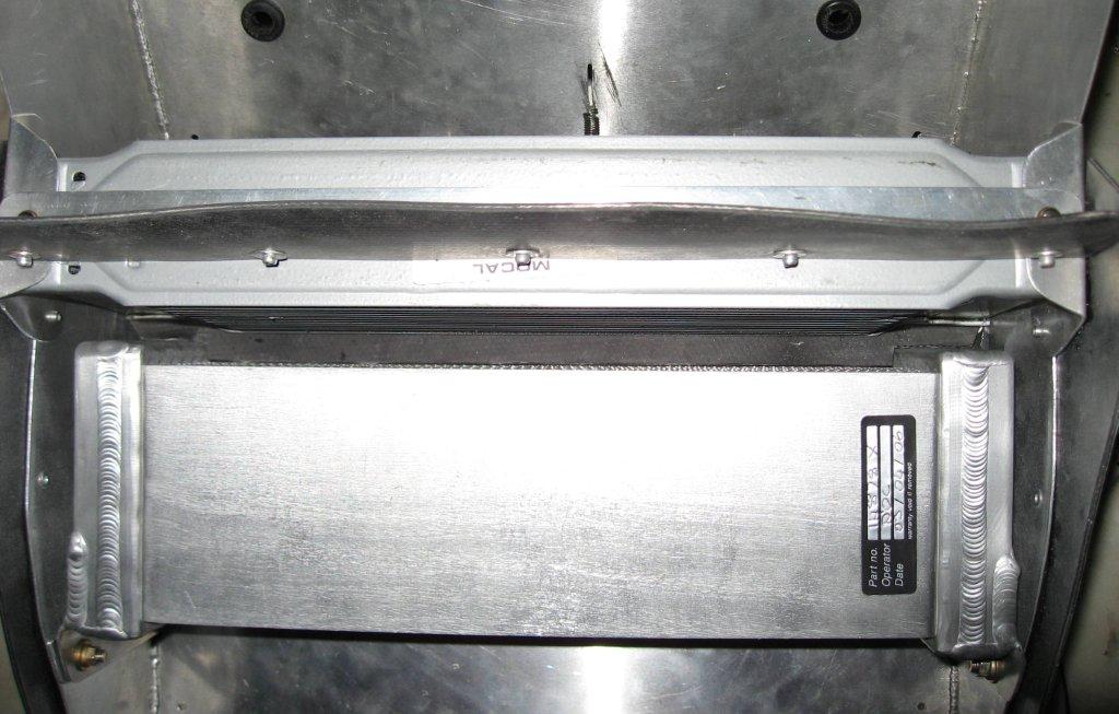

Gentlemen,
Although my initial cooling issues have been improved upon, I'm not
satisfied at all with the cooling of my 914.
Now, with increasing ambient temperatures, I have to severely limit my
climb outs. Cruising is ok. During climb, both the water temperature and
oil temperature approach the red line, more or less at the same time.
Water temperature recovers faster than the oil temperature after I power
down. At this time I can barely make it to circuit height and then have
to level off, build more speed, and then limit my climb with 200 ft/min
until I'm in cooler air. The engine has now 32 hours on it, so it might
still improve somewhat further, but I don't expect miracles from that.
I had to do something.
First I made an additional exit in the cowling, under the turbo, hoping
to provide more airflow. Whether the airflow in the cowling improved I
don't know, but it had zero effect on the water and oil temperatures.
Temperatures inside the cowling seem to be ok anyway, no discoloured
spark plug indicator labels (still bright yellow), no melted tie-wraps, etc.
My conclusion was that the problem is not in cooling of the cowling, but
somewhere in the efficiency of the radiators.
So then I built a new radiator inlet, somewhat larger than previous one,
with a lip to avoid digesting the boundary layer and making sure the
inlet receives ram air, angled straight into the airflow, and with a
diffuser for which I copied a profile out of a famous book.
It was no improvement over my "free style" sleeker inlet and diffuser.
None. Very frustrating, as I ruined my nicely shaped and painted
original inlet for this.
I need to do something, but to avoid ruining again something in order to
solve this problem, I need to hear some experiences:
1) A shroud over the cylinders. I don't have it, but instead I have two
naca ducts in the upper cowling, curved down to release air aimed at the
cylinders.
Has anyone ever tried whether the Rotax shroud (or home made shroud)
makes any difference? Sure, it will cool the cylinders, but does it have
any effect over the water temperature and/or oil temperature? Or is this
again going to be a loss in time and effort?
2) In my setup the oil cooler receives exit air from the water cooler. I
know there is a "trick" mentioned in the build manual for hot climates
to lower the oil radiator 2 inches to receive cold air instead of warm
air, but I didn't opt for this as I don't consider our climate as
extremely warm, and in winter the oild could actually get too cold.
Has anyone tried both options, and did it make much difference? Also,
did it have any influence over the water temperature? Relocating the oil
radiator will be a large project, and I fear that after that I will
still have to limit my climb outs to avoid the water from boiling.
Yesterday on the airfield I took a closer look at the Rotax 914 equipped
Dimona, which is used by the glider club to tow all day long gliders,
with full power at 50 knots, in all ambient temperatures. They never
have cooling problems.
What I saw was shocking. The water radiator is fully exposed to the
airstream, no diffuser whatsoever, it is just part of the cowling, as if
someone took out some skin of the cowling and fitted the radiator in the
resulting hole. The oil radiator is mounted in an angle behind a naca
duct (I was taught that a naca duct does not provide ram air and
shouldn't be used for cooling a radiator?). Both radiators just dump the
warm air inside the cowling! It can't be easier than that.
Then, at the bottom, the Dimona has a cowl flap which just opens the
cowling to dump *all* air overboard. If it is closed, all radiators, as
well as all cowling ventilation, is blocked.
How can this system, which looks less sophisticated than our system,
while violating all rules and knowledge, work so well?
Anyway. At the moment I'm grounded, can't fly like this, and after
spending a week trying to improve things with zero effect, I'm out of
options and I'm inclined to leave the airplane in the hangar and find
another hobby. Sad
Seriously, what should I do?
Frans

Be 100% sure that no air are bleeding out through gaps around your air baffles! Just a little gab is enough to spoil your day. Regards Gert
OY-GDS / mono / 914 / 500 hours
baffles!
I replaced the entire Europa duct, but it mates with the cowling at some
point of course. I didn't have the impression that it was very leaky,
but at the moment I'm waiting for PUR-foam to cure (one side taped off
of course) to see if there was indeed a leak. I'm hoping there was a
leak, and I saw some bugs piled up in one corner just before the
radiator, so that is a hopefull sign. Smile
Frans

Frans and all
My aircraft (G-IANI)is a 914 with no shroud and the standard cowl. The aircraft ran hot on UK “hot” days until I lowered the oil cooler. We also had the same with G-IRON.
Lowering the Oil radiator as far as possible and ensuring complete sealing all round fixed the problem. They both run cool in winter (oil temp 70 – 80c rather than the desirable 100c and this is the reason for the thermostat mod.
I have used a rubber strip attached to the top of the oil rad to seal the gap between it and the water rad. This stops the air taking the short cut. You can just see this seal (black rubber) in the attached picture.
I have more pictures and details if you want them.
Ian Rickard G-IANI XS Trigear, 300hours
Europa Club Mods Specialist
e-mail g-iani(at)ntlworld.com
 Filesize:  105.13 KB
 Viewed:  18533 Time(s)

When I saw the Europa radiator setup for the first time, I had some
doubts about it. But because the Europa lacks a thermostat, I figured
that the oil cooler behind the water radiator was on purpose, to prevent
the oil temps from dropping too low. The manual explicitely calls for
"hot climats" to use the "option" to lower the oil radiator. With
hindsight, I think this description is somewhat misleading.
As some have noticed, I trimmed down the cooling duct considerably,
added a diffuser, added a cowl flap, to optimize both aerodynamics and
cooling capacity. Although it seems my ship is indeed quite fast for a
tri-gear, the oil cooler is not going to work efficiently this way. Too
bad that I don't have room to lower the oil radiator, so I'm going to
have to relocate the oil cooler. I now appreciate the term "experimental
airplane". :-S
Some have mentioned that the exit area of the cowling might be a
problem. However, so far I have no indication that the exit area is the
bottleneck. In area it is bigger than the inlet, and I have no signs of
elevated cowling temperatures like discoloured spark plug labels. Also,
some experiments to open up more cowl space had zero effects on the
temperatures.
I'm glad to hear that the Rotax shroud isn't a necessary item.
Thanks everyone!

frans(at)privatepilots.nl
PostPosted: Sat Jun 05, 2010 11:23 am    Post subject: Cooling issues, once again! Reply with quote
On 06/05/2010 08:38 PM, Mike Parkin wrote:
I have a standard XS 914 installation. In the early days I had a problem
with cooling until I lowered the oil cooler in accordance with the build
manual.
Ok, this is in line with other experiences. Thanks for sharing this.
I refer to your email dated 2 Mar 2009, your theory and confidence was most
impressive.
I was waiting for this to pop up. Wink No problem at all, I'm still
behind it, I just feel somewhat mislead by the strong suggestion of the
manual that the oil cooler behind the water radiator is the standard
setup for normal climats, and I followed that guideline. Granted, I
should have known better.
Anyway, if I write something on this forum, it is "sharing knowledge"
and not a competitive attempt. I will as easily explain why I divert
from the manual some times, and as easily seek for help on this forum if
I experience problems. I don't really care about ego, so I find it
somewhat humorous if an attempt to receive some experiences from others
is answered by an answer like yours.
Perhaps Ivan, Andy and Neville at Europa had a better clue than you give
them credit for.
IF their original setup, with the non-lowered oil radiator as the
factory manual calls for, works better than my current setup. And that
remains to be seen...
At least it looks like my claim to have better aerodynamics might be
true, with a cooling system that performs, let's say, not worse than the
factory setup with the radiators in the "standard" configuration. Wink
Well, I will split up the oil and water radiator, as apparently everyone
has done, and then we can do the comparison again. Wink
If I was one of the boys, I might be tempted to send you a big piece of
'Humble Pie'.
If I was one of these boys, I would be tempted so as well, IF my work
was a masterpiece of enginering, well thought out, working in hot
climates AND cold climates, and with no excess drag, and with even
cylinder temperatures. However, it looks like the standard factory
setup, with the coolers in series, is not exactly the best solution for
everyone.
So, have some fun about me. It is not the first time people laugh about
work in progress. Finally, I might end up with an improvement over the
factory setup, in both aerodynamics and in cooling capacity. Goal 1
appears to have been achieved already. I consider solving problems as a
privilege of building the airplane yourself, and you can't have it right
the first time everyime.
Frans
PostPosted: Sat Jun 05, 2010 12:34 pm    Post subject: Cooling issues, once again! Reply with quote
On 06/05/2010 09:26 PM, Rob Housman wrote:
Having said all of that, there is no doubt that “re-using” the cooling
air will affect heat transfer within the radiator using pre-heated air,
and this is undoubtedly why Europa recommend placing one below the other.
Another reason might be that the oil cooler in the air exit path of the
water radiator is an obstacle that hinders the air flow in the water
radiator?
Looking closer to both radiators, It appears to me that the oil cooler
has closer spaced fins, thicker fluid canals, and an overall smaller
useful area.
It might be that this is the reason why lowering the oil radiator also
causes the water temperatures to drop.
Frans
