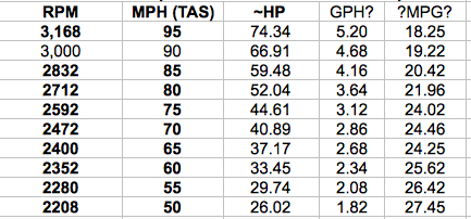

Slingshot with Jabiru 2200A 80hp engine.
The max rpm achievable in S&L flight with the current prop is 3168 though the redline is 3300 where the max hp of 80 is achieved. These numbers were with the big 800x6 tires and taken at about 1,500' density altitude.
Numbers are in attached image.
 Filesize:  140.4 KB
 Viewed:  17475 Time(s)

http://forums.matronics.com//files/n64086_numbers_230.jpg is a good example
of how far you can travel by slowing up. Drag increases with the square of
the velocity. With this performance and if one is not flying into a head
wind, one could get almost ten miles per gallon further by slowing up.

I checked out your spread sheet. And I extended your graph to include 100
mph. I did this by determining the hp difference in the previous two 5 mph
jumps. There is an old statement that says,,, to double the speed
requires 4 times the hp. Seems that your chart is very close to this
statement. The one thing I had never done was check the mpg at different
power settings. Thank you for your effort.

Nobody asked so if you are not interested in more detail about the data in my table, now is the time to move on to next post. However, I suspect one or two might be interested in the extra detail, so here it is.
FYI regarding my spreadsheet table data.
The TAS and Engine RPM were taken from actual testing, multiple times. The TAS being the average of GPS groundspeeds straight upwind and downwind. All of this was done at about 1,500' density altitude.
The HP being developed(absorbed by the prop) and the fuel burn rate (GPH) was from the Prop Selector program assuming a fixed fuel consumption rate per horsepower hour, .42 lb/hp/hr quoted by Jabiru. As it turns out, the effective pitch of my prop 64x31 is closer to 39" according to the Prop Selector.
The MPG was a simple division of MPH by GPH.
If you look carefully at the data, you may notice a wrinkle in the MPG numbers between 65 mph and 75 mph, wherein the 70 mph airspeed yields a slightly better MPG than either side of this number. Either my numbers were off a bit during the testing or this happens to be the best speed for my Slinghsot that is a compromise between time-to-destination and fuel burn/mile. I suspect it is the later since these numbers are averages of multiple tests on different days.
At higher density altitudes one can expect higher TAS for a given engine power output but it takes more throttle opening and higher RPM (fixed pitch prop) to get the same power output. I flew an hour plus taxi and warmup time this morning and climbed to 8,000' DA and measured a TAS of 84.5 mph at the same power setting as I see 80 mph at 1,500' DA. The rpm to achieve the same power at the higher DA I calculated to be about 2850 instead of 2712 at 1,500' DA. To maintain same power setting for a full hour, I did the climb at the same constant power setting gradually increasing rpm at a rate of about 25 rpm per 1,000' of increase in DA. After landing and refilling. I calculated my new fuel burn rate at this power setting to be about 3.5 gph. So, at altitude, I can expect about 24 mpg at about 84 mph.
requires 4 times the hp...
Actually, to double the speed (all other things being equal) it takes 8 times the power to double the speed. It's not quite equal, of course, and thus not quite 8X as at higher speeds the AOA and thus the induced drag will be less.
