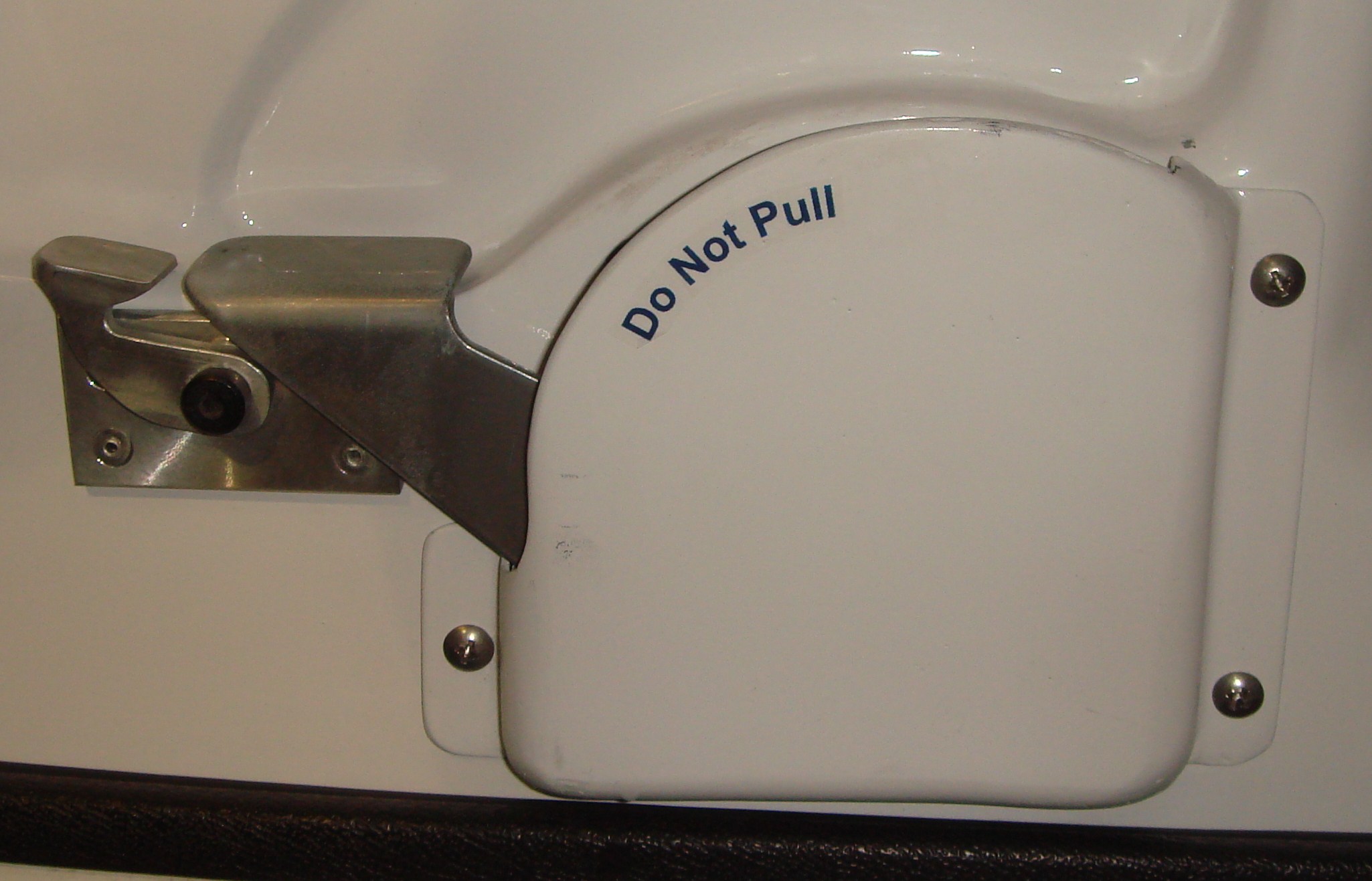

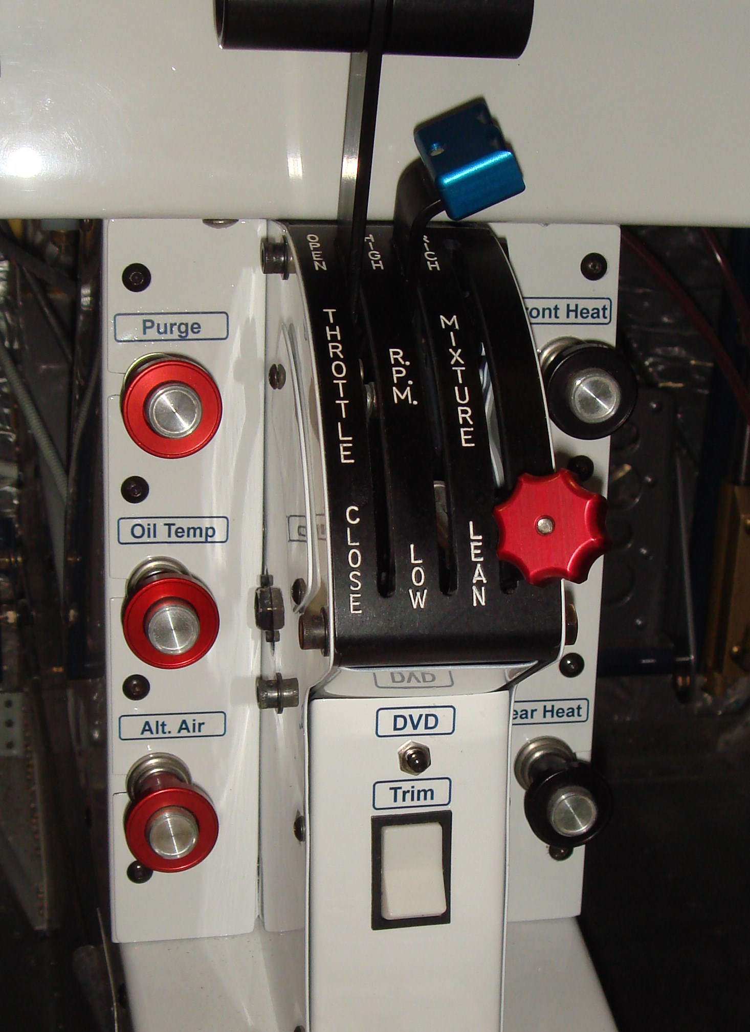

PostPosted: Fri May 21, 2010 8:23 am    Post subject: Door handle label Reply with quote
If you have access to design / layout software (I use Adobe Illustrator)
you can layout all your markings / labels in any color, size and shape you
wish. Then send the file to Stein and for something like $20.00/sheet he
can reproduce the info on long lasting, UV resistant water floatable
decals. Then just trim, drop in a glass of water, wait a few seconds slide
off the backing and slide into position and let dry. It's about the
easiest part of building a plane and can look ultra professional. On my
next plane I plan on leaving my panel and breakers un-labeled and creating
the graphics myself using this technique. This allows me flexibility if I
choose to rearrange my breakers or switches etc... Attached are two photos
of my labels applied in place.
