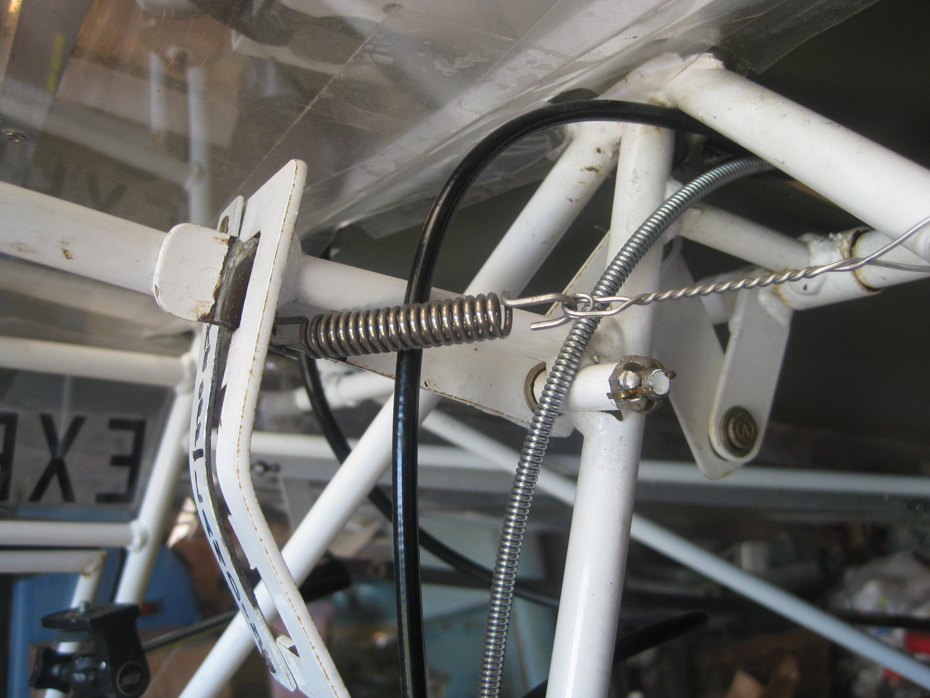

I attached a spring to hold it in the detent...it works well...I will take a picture and post to see....

the spring works great...holds it tight to the detent and doesn't rattle around wearing it out....for what it's worth...
