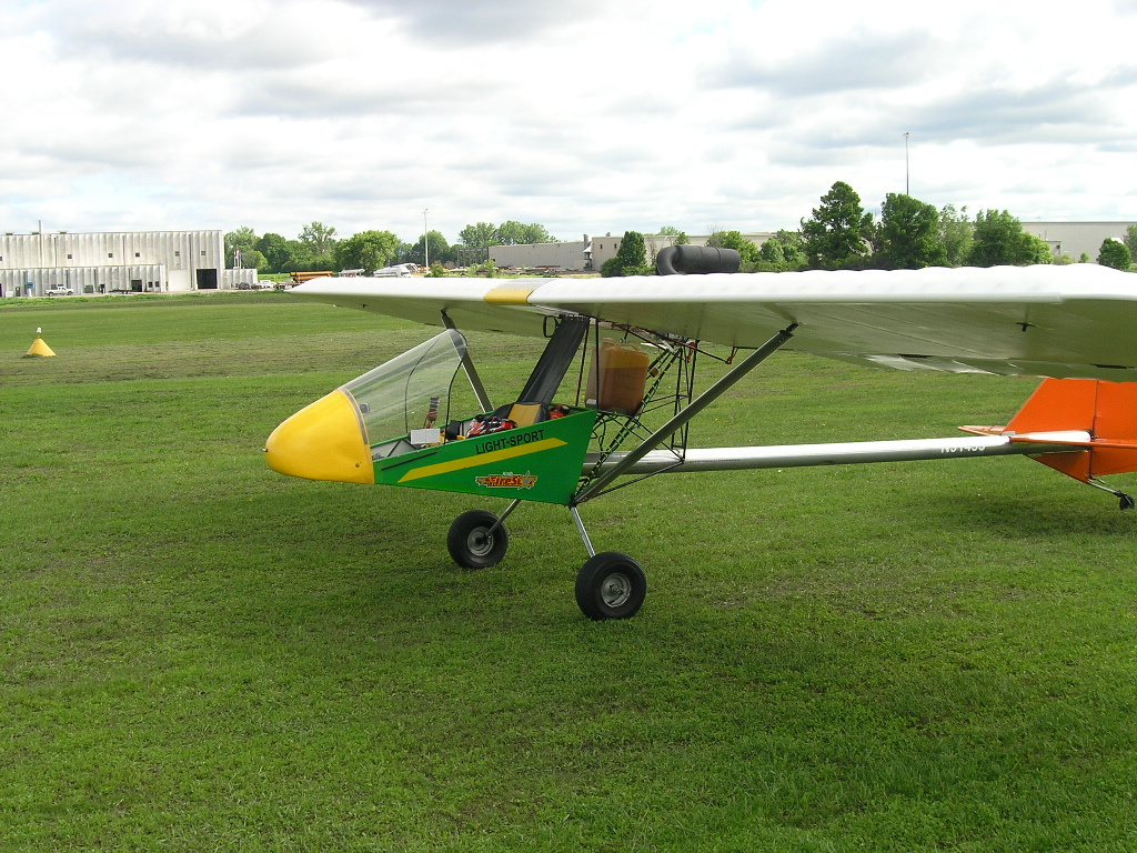

PostPosted: Wed May 05, 2010 10:45 am    Post subject: Re: Firestar Reply with quote
Bill, I decided not to cover the rear cage, but cover the front part. It has several advantages. It's lighter (that was a concern in the 103 days), it flies faster uncovered (covering around the cage in back of the seat acts like a parachute w/o a full enclosure), and lastly I can remove/inspect the tank/fuel lines easier.
Ralph
