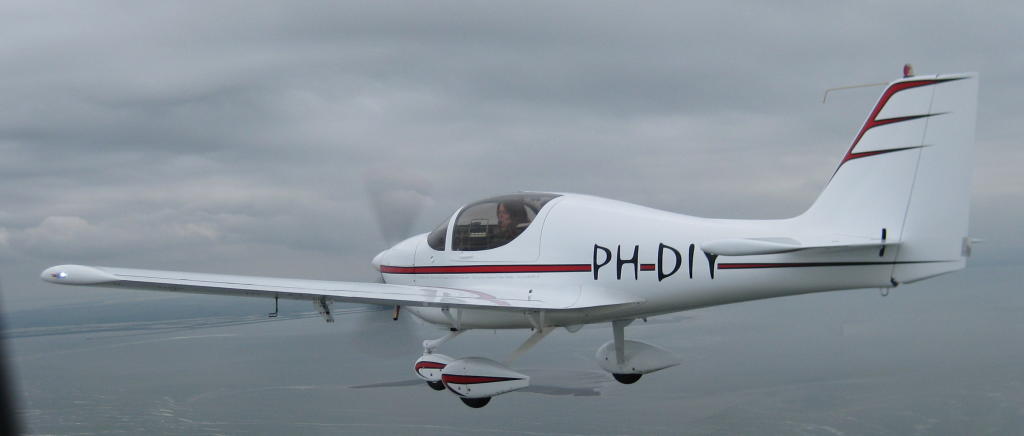

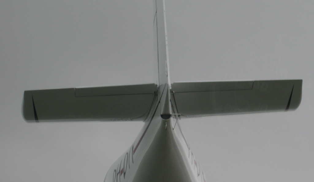

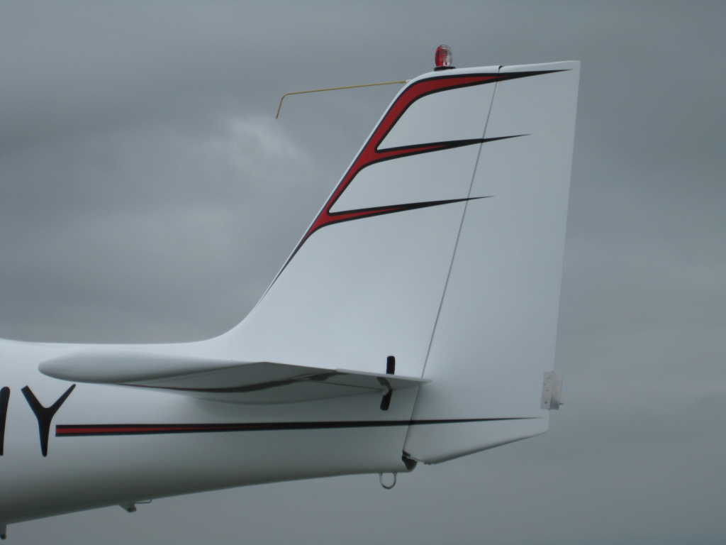

On 04/12/2010 08:06 PM, Peter Zutrauen wrote:
I'm perplexed - all the photos I've ever looked at of Europas in cruise,
the trim tab is *up* (as others have noted), thus the flying elevator is
by definition providing *lift* to the tail.... a contradiction to my
teachings.
Let's add some more to the confusion...
Especially for those who claim never having seen an Europa with the anti
servo tab NOT in the up position, here are some pictures we took when
flying our PH-DIY in formation with the PH-JAI from Tim Weert.
As you can see on the attached pictures, the PH-DIY has the anti servo
tab perfectly in line with the rest of the tail plane (as it should be,
because it is an anti servo tab, who's task it is to drive the tailplane
until it is line with the trim tab).
Frans

peterz(at)zutrasoft.com
PostPosted: Wed May 12, 2010 3:05 am    Post subject: Effects of Flaps and Ailerons on Pitch Trim Reply with quote
Thanks Frans!
*Very* interesting.
just a note - my original statement below is wrong - as an upward trim tab results in a downward force on the tail, not lift as I had originally (incorrectly) thought.
questions:
- were you in stead-state constant-altitude cruise?
- where was your trim set at?
- was your stick force = 0?
- what was your cruise speed?
- what was your weight and balance (with fuel at that point in time)?
As the tailplane is a symmetrical airfoil,  my confused mind asserts that in cruise (since the horizontal stab by definition must be providing a downward force) your tailplane must have been at a negative angle of attack, and since the combination anti-servo/trim tab was in a neutral position then I would have expected a steady stick force would have needed to be applied.... or a far aft CG condition would have been needed?
Many thanks!
Pete

PostPosted: Wed May 12, 2010 4:56 am    Post subject: Effects of Flaps and Ailerons on Pitch Trim Reply with quote
This is an *anti servo trim tab*, if it is not in line with the
tailplane, it puts a force on the tailplane so that the tailplane
rotates until it is in line with the anti servo trim tab again.
You can easily see what I mean by exercising the trim in whatever
position, and then carefully with your hands on the anti servo tab, try
to push it in line with the tailplane again. You will see that the
tailplane rotates during this process, and that you will always end up
with the anti servo tab in line with the tailplane.
This is true for *any* speed, *any* CG, etc, except when the pilot
exercises some force on the stick. Any force on the stick gets into the
equation and disturbes this balance.
If you trim for a specific speed, all you do is put the stick in a
specific position, and then with the trim button, line up the anti servo
tab with the tailplane, to keep the tailplane at its new position. You
will always end up with the anti servo tab in the same relative position
of the tailplane.
The real confusion is that there are people flying around with the anti
servo tab not in line with the tailplane. This means they are either
pulling or pushing slightly on the stick, or that the tailplane is not
balanced out properly.
About the latter: I disconnected everything from the tailplane when
balancing it out. If you leave the stick connected, you won't get a
proper balance and the anti servo tab will not find its equilibrium in
Next time we do this, I will vary the speed, trim for each speed, and
make a picture again. I would be really surprised if at any speed the
anti servo tab will not remain in its same relative position to the
tailplane. (Of course at every speed, the whole stack of tailplane plus
anti servo tab will rotate to a specific position... but with the anti
servo tab always in line with the tailplane. This is what you do if you
trim: lining the anti servo tab up with the tailplane in its new position).
Now, for your questions (although they don't matter):
Yep. (We were in close formation so we wouldn't dare to fly anything
than a very stabilized attitude).
At 1/3 from the nose down limit.
Of course 0.
About 110 Knots.
Two adults, about 20Kg of bagage, and about 40 liters of fuel.
Frans
of the tailplane.
Of course 0.
About 110 Knots.
Frans

I looked at in flight photos of N211KA and at about 120knots the tabs indeed are even with the TP.

frans(at)privatepilots.nl
PostPosted: Thu May 13, 2010 6:04 am    Post subject: Effects of Flaps and Ailerons on Pitch Trim Reply with quote
On 05/13/2010 03:12 PM, Peter Zutrauen wrote:
The confusion around this topic (thus your "failure" Wink may be (/at
least it was in my case/ Razz ) that one has to accept the fact that the
design's torque tube placement results in a (symmetrical airfoil)
tailplane is *aerodynamically balanced* for Frans' functional
description to make sense. ie- no matter what the steady-state angle of
incidence is of the tailplane, there are no resultant stick forces which
need to be zero'd out by a portruding trim-tab ( which is the anti-servo
tab in this case).
Ah, OK, now I see your point.
I thought that this aerodynamically balance was the major "selling
point" of the tailplane, and hence common knownledge amongst builders. I
recall having read somewhere that the whole purpose of the mass balance
arm is to cancel out the weight offset, which is a *result* of having
the torque tube in the aerodynamic center, rather than in the weight center.
I have to admit that it took me a while too before I grabbed the
concept. The whole arrangement with the anti servo tabs which double
duty as trim tabs at the same time is indeed a genious concept. If the
anti servo tabs are always in line with the tailplane, there is never a
drag penalty, regardless of trim setting. This is just one of the things
that make the Europa a relatively fast airplane.
Then you can maybe understand that I found it rather shocking to read
that "all Europa's are flying with the trim tabs deflecting upwards"...
as this would defeat the whole purpose of the ingenious anti servo tab
and all flying tailplane. I was prepared to find a way to fix this
problem once I would reach the flying stage... until I discovered to my
delight that the PH-DIY doesn't suffer from this problem at all.
I'm still curious however why some Europa's suffer this problem.
I'm still curious how close to perfectly aerodynamically balanced the
tailplane design is. Don Dykins sure was a clever fellow.
Was Don Dykins responsible for the tailplane too? He was indeed a clever
fellow.
Frans
