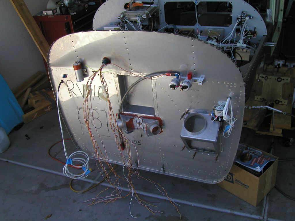

We used an engine leveler on the engine jack and marked the links on the
chains to the mounting ears so that once the engine mount was on the
firewall and the fit was good, we could duplicate the engine on/off
procedure very easily. Then, as with everything else on this project, when
you do and re-do, it's not a big deal. I.e., after all the cowl/prop
measuring and fitting, it was easier to remove the engine and replace it
with two 5 gal. jugs of water for counter wt. for painting and firewall
wiring etc.

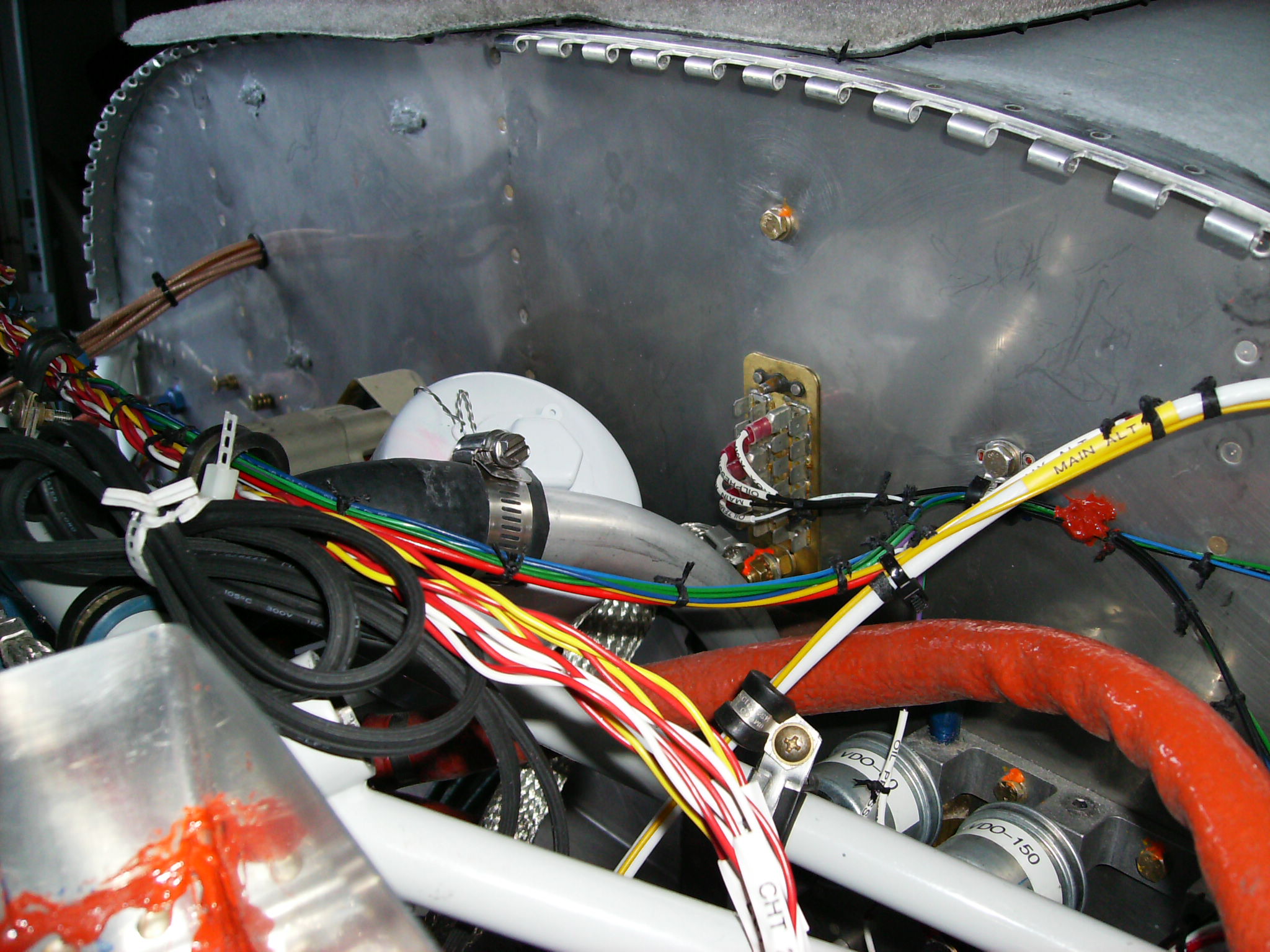

Once you plan all your firewall forward plumbing and wiring, it is MUCH
easier to run your cables to the heater vents, for example, with the engine
off. Think about parking brakes, brake resevoir, heat shield, other stuff
you might want to rivet on to the firewall. Again, with the ease of
temporarily installing the engine, don't think of it as "once it's on, it's
on for good".
Maybe (hopefully) you've already done your wiring/panel layout and
construction, but I did not like the tight fit of the battery cable through
the firewall where Van's shows it, and went with the bigger insulated
bulkhead connector as in William Curtis's site
(http://nerv10.com/wcurtis/90Electrical/EL1h.html). That also gives you
cabin side direct access to battery +. I wouldn't even punch that hole in
the firewall where the instructions say. And don't forget the diodes
across the master, and starter solonoids, as seen in his pictures.

yes but have the wiring, cables, etc run through the firewall first

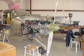

Here's a slightly different engine mount....

Posted: Fri Apr 09, 2010 8:22 am Post subject: Re: Before mounting engine |
Riveting the cowl hinges before attaching the engine mount is a good idea as the mount gets in the way of several hinge rivets. By the time I realized this, the engine was already hung and it got interesting.
I pulled FW wires after the engine on without problem. One advantage of doing it this way is that everything is known to be accessible after the fact.
Attached forest of ground tabs to FW before engine on.
Mounted LSE Electronic Ignition to aft side of FW before engine on.
Install of air vent control cables after engine on doesn't look like fun as there's little clearance. I didn't have my cabin mounts done at the time, so I'll be the poster child for doing it backwards.
Ran engine control cables after engine on without problem. Would have been easier beforehand though.
Jay

rleffler
Joined: 05 Nov 2006 Posts: 680
Posted: Mon May 03, 2010 6:11 pm Post subject: Re: Before mounting engine |
| jayb wrote: | Riveting the cowl hinges before attaching the engine mount is a good idea as the mount gets in the way of several hinge rivets. By the time I realized this, the engine was already hung and it got interesting.
Jay |
Jay,
Do you have a photo of your firewall that you can share? I haven't installed the mount yet, but am looking to install the forest of tabs and the the fat cables this coming weekend. My concern is that I'll install them someplace where I wish I hadn't after the engine gets mounted.
thanks,
bob
_________________ Bob Leffler
N410BL - Phase I
http://mykitlog.com/rleffler |
| Back to top |
hotwheels
Joined: 01 Jun 2007 Posts: 240
Posted: Tue May 04, 2010 5:31 am Post subject: Re: Before mounting engine |
Photo is attached. No warranties as I'm not flying yet. Aft tab access may be less fun than the firewall side.
Jay
