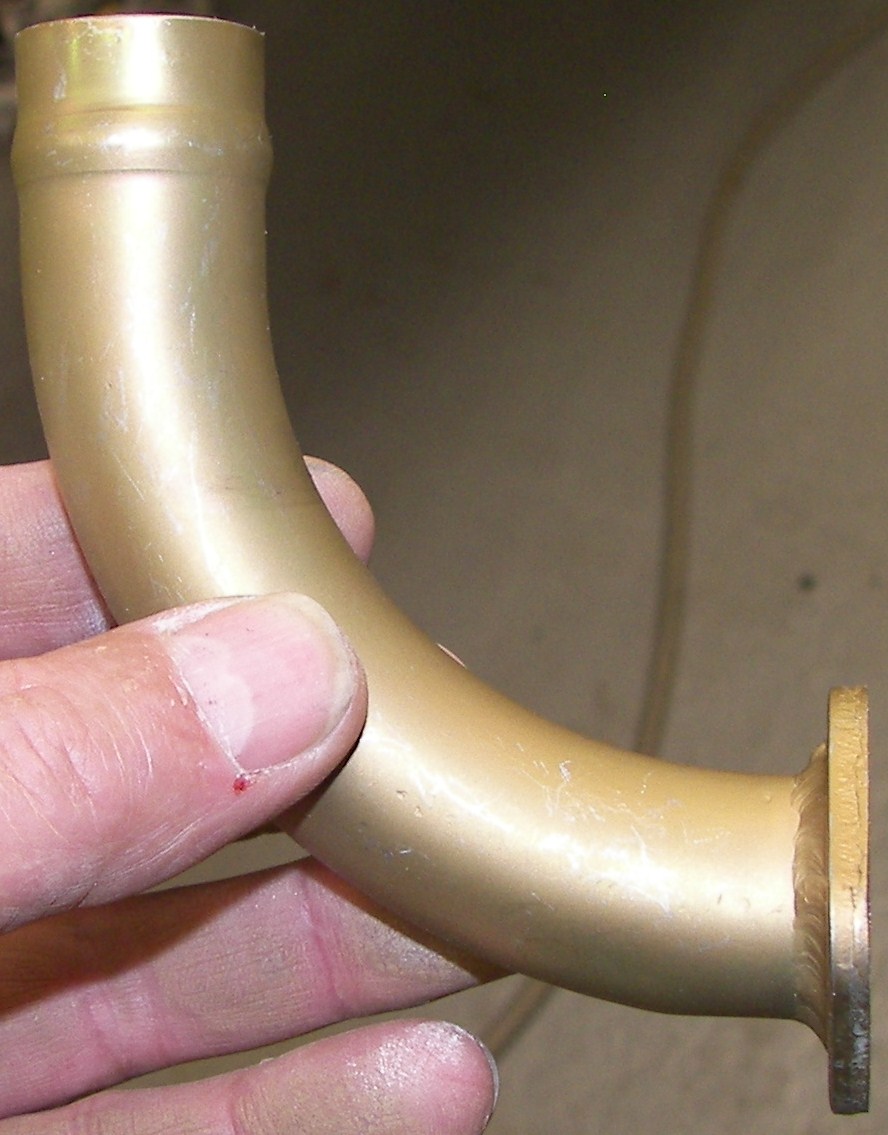

PostPosted: Sun May 02, 2010 10:57 am    Post subject: Re: 912ULS Water Inlet Part 922 218 Reply with quote
Note: I resized the picture and uploaded it again. Sorry bout that.
I'm glad that I posted this problem on the Rotax Forum. Paul Mitchell, the Tecnam dealer in the UK had the perfect fix for my issue. Paul was coming to SNF and parcel posted it to me when he got here. I received it the next day and went out to the airport and replaced the stock one with it.
Ain't it great how folks like Paul will go out of their way to accommodate those of us in the builder community?
Tommy Walker the happy camper

craig(at)craigandjean.com
PostPosted: Sun May 02, 2010 11:15 am    Post subject: 912ULS Water Inlet Part 922 218 Reply with quote
So what was the fix? What does it look like and where does he get them from?
Pictures?
-- Craig

Tommy Walker
Joined: 12 Jan 2006
Posts: 442
Location: Anniston, AL 36207
PostPosted: Sun May 02, 2010 12:27 pm    Post subject: Re: 912ULS Water Inlet Part 922 218 Reply with quote
Hi Craig,
I uploaded a picture with the post. You may have to go to the forums.matronics website in order to see it. It was sort of a big picture. What they did was take a piece of flat stock and some tubing and make a ninety degree El (is that redundant?).
The picture is too big and your email server may have stripped it out.
Let me know if you still can't see it on the matronics site and I will email a smaller version to you.
Tommy
PostPosted: Sun May 02, 2010 12:53 pm    Post subject: 912ULS Water Inlet Part 922 218 Reply with quote
Got it, thanks. I wonder how the rest of the world solves the problem.
Wouldn't anyone with the ring mount need a similar solution?
-- Craig

Tommy Walker
Joined: 12 Jan 2006
Posts: 442
PostPosted: Sun May 02, 2010 1:09 pm    Post subject: Re: 912ULS Water Inlet Part 922 218 Reply with quote
I would think so. Someone said Rotax said to rotate the inlet neck and thread the hose in front of the Ring Mount. That wouldn't work in my situation.
Oh well....
