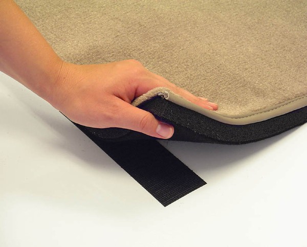

PostPosted: Tue Apr 27, 2010 10:40 pm    Post subject: Carpeting Question Reply with quote
My Classic Aero Carpet has the sound proofing foam glued to the back of
it and it fits tight and no glue or velcro is needed.

robin(at)PaintTheWeb.com
PostPosted: Wed Apr 28, 2010 9:10 am    Post subject: Carpeting Question Reply with quote
My Bobby, you have lovely hands...
Robin

PostPosted: Thu Apr 29, 2010 12:04 pm    Post subject: Carpeting Question Reply with quote
I worn gloves while I was building Smile
