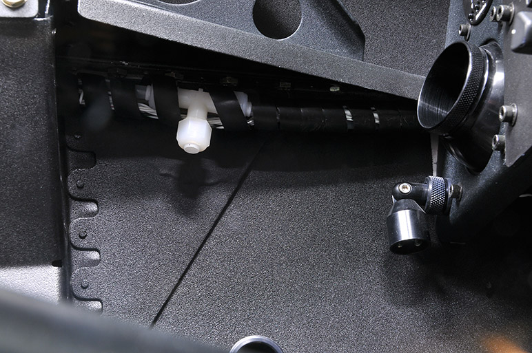

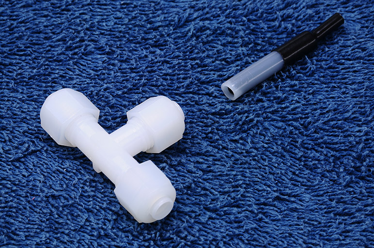

What a great idea, Linn! Thanks. Here's what I did tonight including a couple of pictures...
I added a small "T" Nylon fitting in the 1/4" tube for static air just in front of the instrument panel under the left cockpit rail. I cut a short piece of 1/4" tubing and filled it with black RTV and then put a piece of heat shrink tubing over it to form a handle. The whole thing fits nicely under the cockpit rail and from the pilot's position is just barely visible, yet can be accessed easy. In the event that icing conditions occur, the fitting can be unscrewed and the plug removed for cabin venting.
