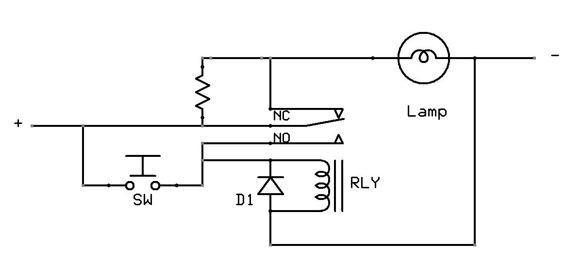

I'm starting a significant upgrade of the VFR-only panel in my flying GlaStar to an IFR panel. I currently have the B & C Specialty LR3C-14 alternator controller and will be installing the B & C SD-20 standby alternator with a SB1B-14 controller. The currently installed low voltage light will be replaced with a "standby alternator on" light.
The current warning light is way too bright, especially at night. I expect the standby alternator "on" light to be just as bright.
Is there an easy way to dim the light after it has come on and gotten my attention? If dimming it is too difficult, I'm thinking of adding a small switch so I can shut it off after it has come on. This switch would be normally "on" and I'd have to add that as a checklist item.
I already have and will continue to use a B & C dimmer (DIM5-14 or DIM15-14). If I recall correctly, it will handle two or three different circuits. Can it be wired such that it will dim the warning light while increasing the brightness of the other circuit -- say my other panel lights -- or do all circuits have to work in the same direction? If it can dim one circuit while brightening up the other, I think I could find a happy medium and use existing hardware.

Here is a circuit to dim a lamp.
http://public.bay.livefilestore.com/y1pnjhA-QOagoszIUOS_iGTx6Uw9gnQ1G-xEr5gCUrpDQ4RGg9zXqzo-0gwBpbT2GBxlz9tWj7Y1QjbnTMtbIq4Sw/Lamp%20dimmer.jpg
The lamp will illuminate normally until the momentary switch is pushed. Then the relay will energize and hold until the alarm condition goes away. With the relay energized, the lamp current is reduced by the resistor. If it is desired that the lamp go out completely, remove the resistor from the circuit.
