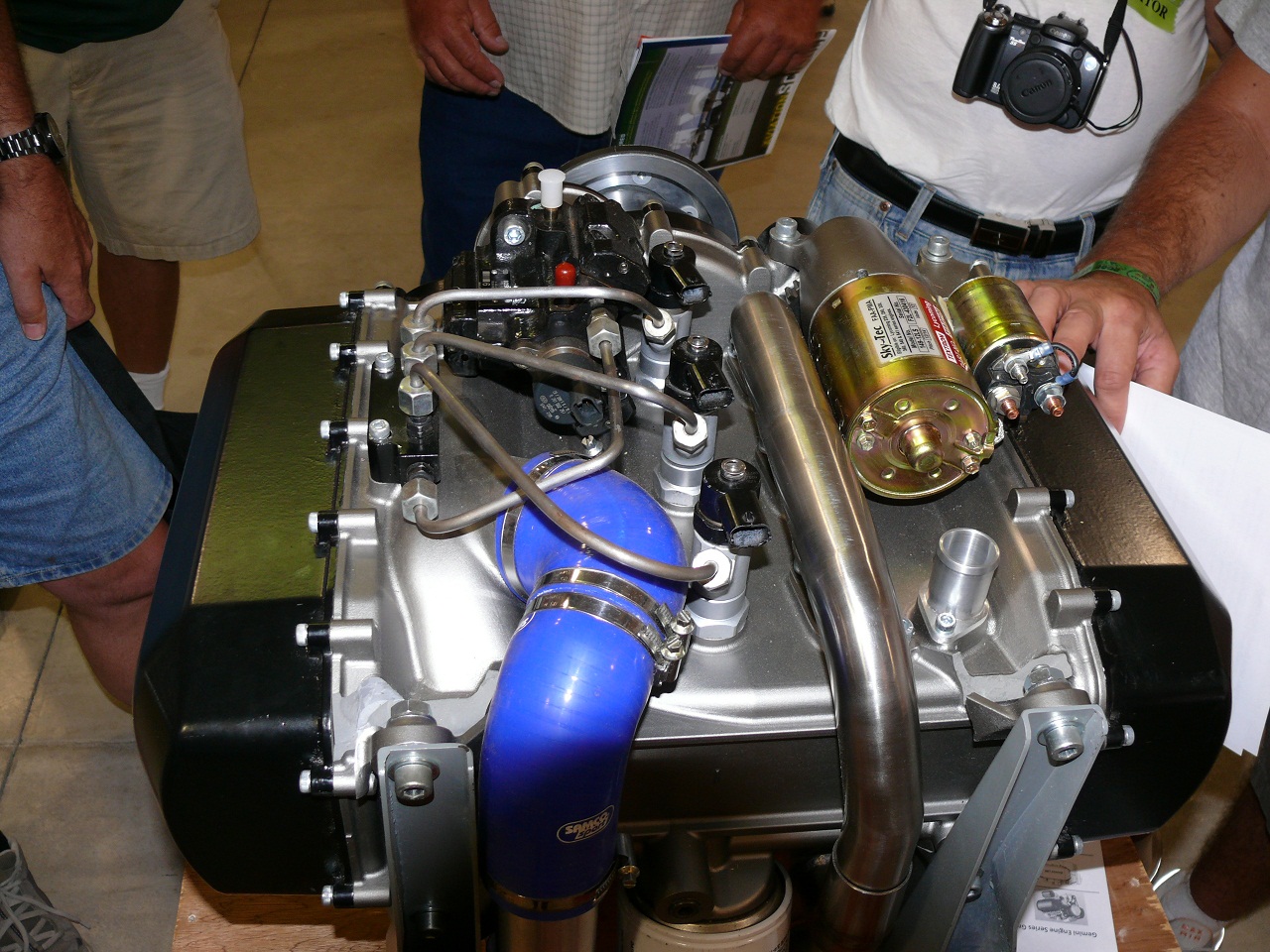

Think about the one blade for a moment. It produces thrust one side of the airplane only, left, top, right then bottom. And that doesn't include the asymmetric effect of angle of attack.The airframe will oscillate in a corkscrew fashion, what a horrible prospect I can almost feel my teeth rattling at the thought of it!
2 stroke diesel? Now that is a good idea, most efficient form of piston engine.
Graham

peterz(at)zutrasoft.com
PostPosted: Mon Apr 19, 2010 3:35 pm    Post subject: 2-blade props Reply with quote
"2 stroke diesel? Now that is a good idea, most efficient form of piston engine."
reborn as the Gemini - Oh how I hope it makes a comeback from the 'new engine development' graveyard.
Cheers,
Pete
A239
 Filesize:  444.58 KB
 Viewed:  13265 Time(s)
