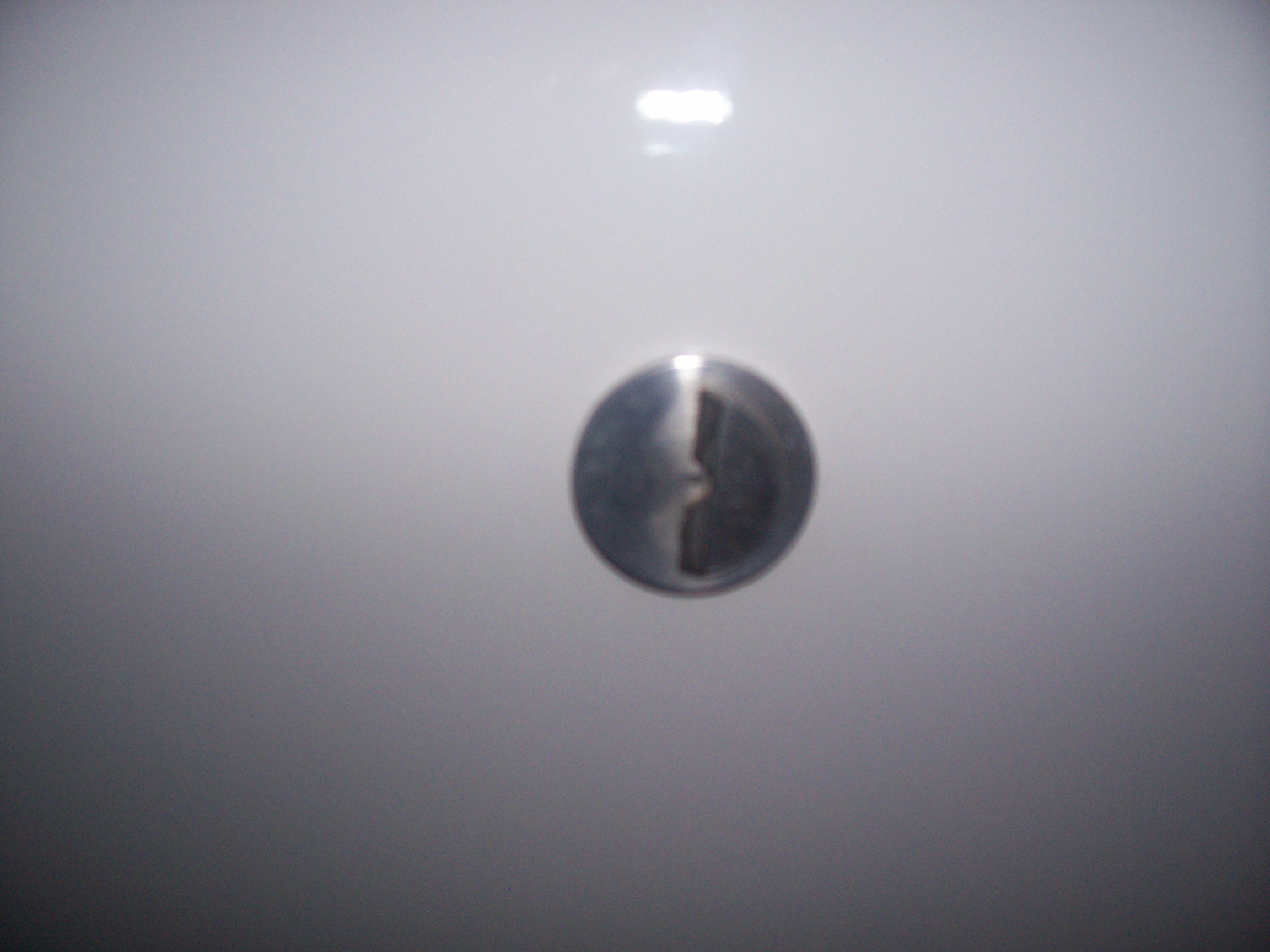

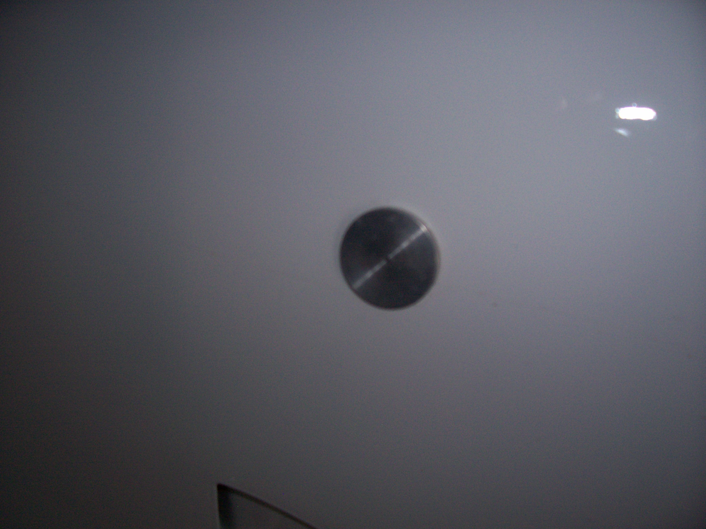

Note Two: So we have built our airplane, installed our static port(s), and
discovered that we are getting inaccurate airspeed and / or altitude
indications and decide to do something about it. We could just go on
installing new static ports in different locations, but that is a lot of
work and we are not assured of better results. So we should do just what the
big boy aerodynamic types do, we fudge or bandaid as needed to get the air
to give us the results that we want.
Let's say that the airspeed indicator is reading too high -- it says the
airplane is going faster than it really is. (See Note Three). The dynamic
air pressure side of the airspeed indicator is providing too much force in
the desired balancing act. How can we counteract that excess dynamic force?
We increase the static force being fed to the airspeed instrument by the
static port by installing a small wedge just aft of the opening on the
static port (thin edge of the wedge facing forward towards the hole). This
small wedge causes air to pile up and increase the static air pressure going
to the airspeed indicator (and also to the altimeter unless you have
provided separate static ports for the two instruments) and give us the
accurate force balance measurement that we want.
Let's say that the altimeter reading goes down 200 feet when you speed up 60
miles per hour (Mike, you did not say which direction your altitude was
changing with the changes in airspeed). This means that the static port is
feeding greater than static pressure as your airplane flies faster. How can
we reduce that undesired increase in static air pressure? We install a small
wedge in front of the hole in the static port (thin edge of the wedge facing
aft towards the hole) to shield it a bit from dynamic air pressure coming
from the front in order to get a more stable and accurate altitude reading.
How do we get the right size wedge facing the correct direction to get the
airspeed and altitude results that we want? The same way the big boys do:
TRIAL AND ERROR and MORE TRIAL AND ERROR. Because our airplanes are
experimental, amateur built we are permitted to do just that -- experiment.

You will have lots of fun doing that. Attached are pictures of my two static
ports, one left and
one right on the forward sides of my KIS TR-1 fuselage.
One has a wedge on it the other one does not. I went through a long series
of trial and error alternately blocking off ports individually and wedging
them in various ways until I became satisfied with my airspeed indication in
the 70 KIAS arena.
The IAS may not be absolutely correct, but I know that when I fly a landing
approach at 75 KIAS and a touch of engine power above idle I should be able
to make a decent flare and touchdown (if the gods are smiling).
