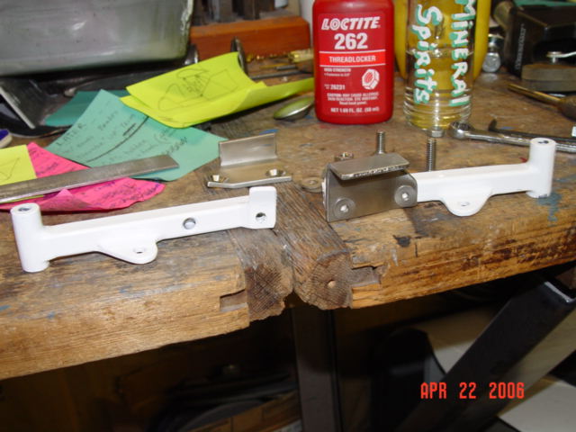

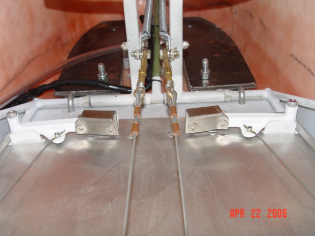

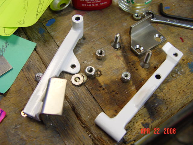

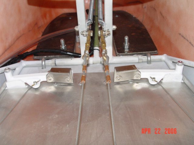

Hey Guys,
Just thought I'd post a few pictures of the angles that I put on
my Heel Brake pedals.....They were too "low" and too far forward....
and I changed their "angle" a little too.....
These "aren't" Stock pedals , but if yours feel awkward, this might work
for you too....
These feel mo Beta now...
Oh,... worth what you paid fer it...
Gotta Fly...
Mike in MN

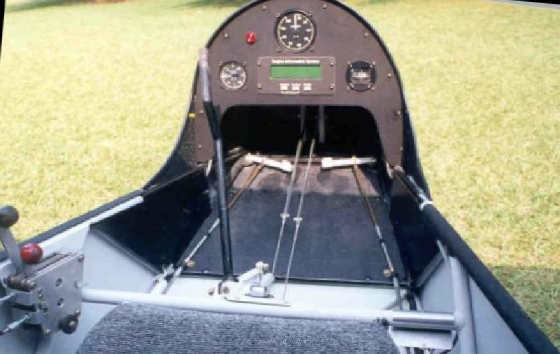

planecrazzzy wrote:
Hey Guys,
Looks Good.
I found some "push/pull" cables that were accidently the right
length. They take a lot of slop out of the Brakes. Most brakes don't have
much room between being to loose and dragging/rubbing anyway.

planecrazzzy
PostPosted: Sat Apr 22, 2006 5:22 pm    Post subject: Re: Heel Brake Modification Reply with quote
.[/quote]
much room between being to loose and dragging/rubbing anyway.[/quote]
Hi Possum,
It also looks like yours is "higher" than mine....Mine were
so low I was scraping the bottom pan pretty bad....
Yes, the brakes have a "Short Range" ...I already had to shorten my adjusters a little....
Gotta Fly...
Mike in MN
