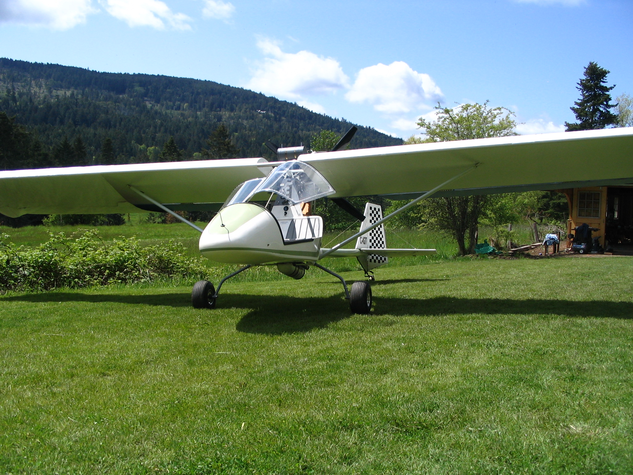

When I was researching which prop to put on my mark II HKS with a 3:47 gearbox I talked to alot of people about airplane noise. My goal was to be as quiet as the 85hp fleet canuck (cub like canadian plane), that flies out of my home strip.
What I learned was that it is a combination of tip speed and pitch which determines noise. (and pusher or tractor) Basically the smaller the "bite"out of the air, each blade takes, the quieter you are.......so, more blades, less diameter, less rpms, = quieter. I have been told by pretty much everyone that hears my plane that it is the quietest plane they have ever heard......it sounds really nice!!!
It has a four blade 68 inch powerfin, with the 3;47 gearbox. Does the 912 not have the option for a higher ratio gearbox ?
Although I realize performance is rather subjective, I am very happy with my combination. Empty weight = 550 lbs HP = 60 Solo climb = around 1000 fpm. Cruise = faster than vne of 75 mph.
...............so, I believe now that Kolbs can be made quiet, with enough money and effort put into them........providing you can slow the prop down. I'm not sure what the gains would be seen by simply adding more blades with reduced pitch, without slowing the prop down, but I'd love to hear about someone experimenting with that.
At the Wallaby ranch in Florida they use Dragonfly ultralights to tow hangliders, and they use two stacked three blade Ivo props, which they say gives them the best combo of quietness and thrust (they dont care about airspeed). cheers, Rob Cannon
 Filesize:  1.13 MB

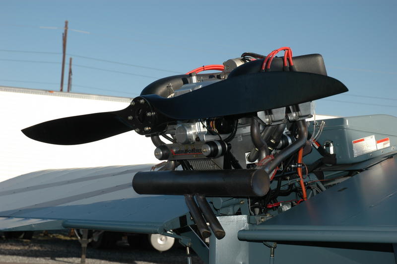

Jack,
Your measured difference of 1 db between 2 and 3 blades of the same diameter and rpm was interesting to learn and unexpected, by me at least. I wonder if the lessor pitch was the actual cause of the slightly reduced noise level or the different beat. I suspect it was the change in blade pitch, as Rob stated. My prop is cut in a scimitar shape so the tip angle is a lot more laid back than the modified tip on yours.
John,
No question that the pusher configuration is MUCH noisier than tractors, but I can't control that factor as long as I'm flying a Slingshot. What I am thinking about though is going to a shorter prop with more pitch like Gary has on his Jab powered mkIIIX. BUT if additional pitch also adds to the perceived noise then it might be for naught.
Prop no longer has the black plastic coating. Just natural wood finish now with extremely hard leading edge protection.
