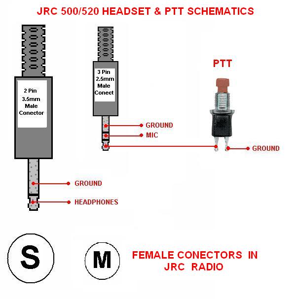

PostPosted: Fri Apr 29, 2011 5:34 pm    Post subject: Re: Jhp 520 PTT cable Reply with quote
I have a JRC 520 and the external PTT work when you ground it.
Here is the HEADSET and PTT schematics
 Filesize:  38.05 KB
 Viewed:  16570 Time(s)
