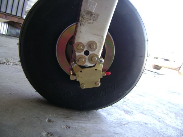

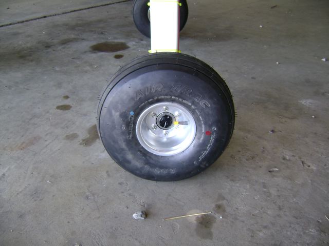

Here are a couple of pics

Looking at the photos that you provided, it appears that you had to modify the landing leg in order to mount the caliper. Does this mean the the provided mounting bracket that is supplied by MATCO doesn't work without modifying the landing leg?
Larry
- The Matronics Allegro-List Email Forum -
http://www.matronics.com/Navigator?Allegro-List
timpry
Joined: 17 Feb 2010
Posts: 10
PostPosted: Fri Apr 23, 2010 6:08 am    Post subject: Re: Replacing the brakes & wheels on my Allegro Reply with quote
I did have to reshape the legs to give the brakes clearance..

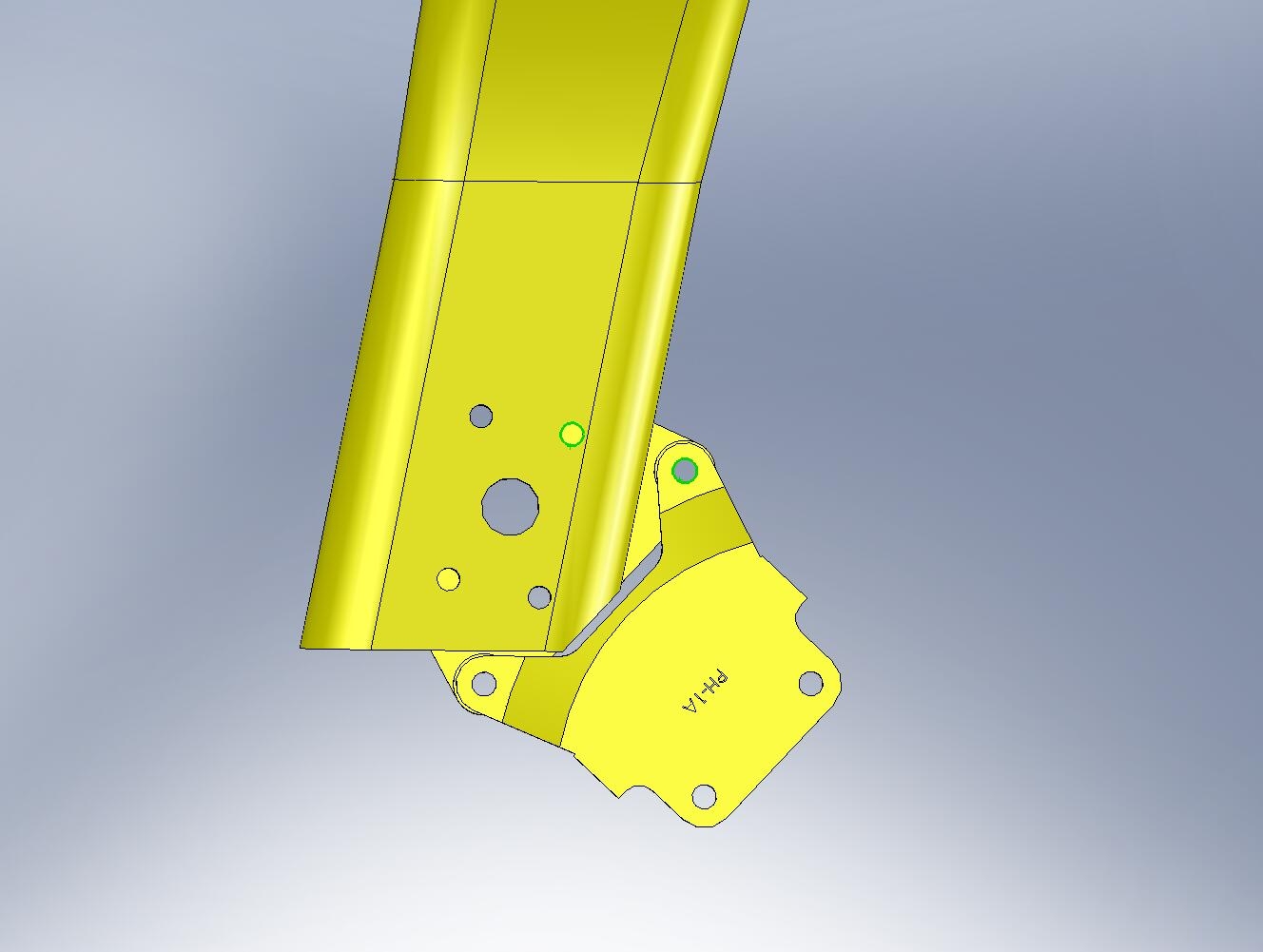

Hi Timpry,
I set up Matco's for the Flight Design CT. I'm also an OEM for Matco. The CTLS model has strut gear like yours. You may have been better off with the right brake (pictured) on the other wheel. You would still have to of had cut the corner at a 45 degree on the bottom back edge just like the CTLS, but the caliper would be in a much better position at 4 o'clock and the brake line and bleeder valve would have been in a more upright position. This would also put them a tad higher so as not to strike a low object. There is also a little different wheel/brake set that the CTLS uses that may have been a bit easier to mount. I have those part numbers if anyone would like them. You also need to go out and burnish the brakes (heat them up). If you don't you sacrifice up to 50% of the stopping power. With the Matco's you should be able to run at WOT and the brakes will hold.
If you call George (owner) at Matco for the Allegro brakes tell him you need the setup for the Flight Design CTLS.

Here is a picture of what it could look like and position the caliper better.
