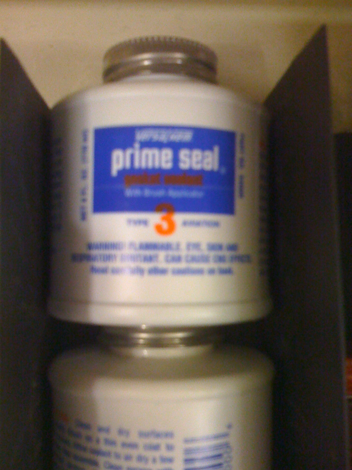

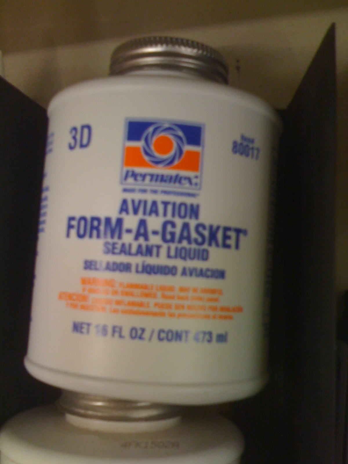

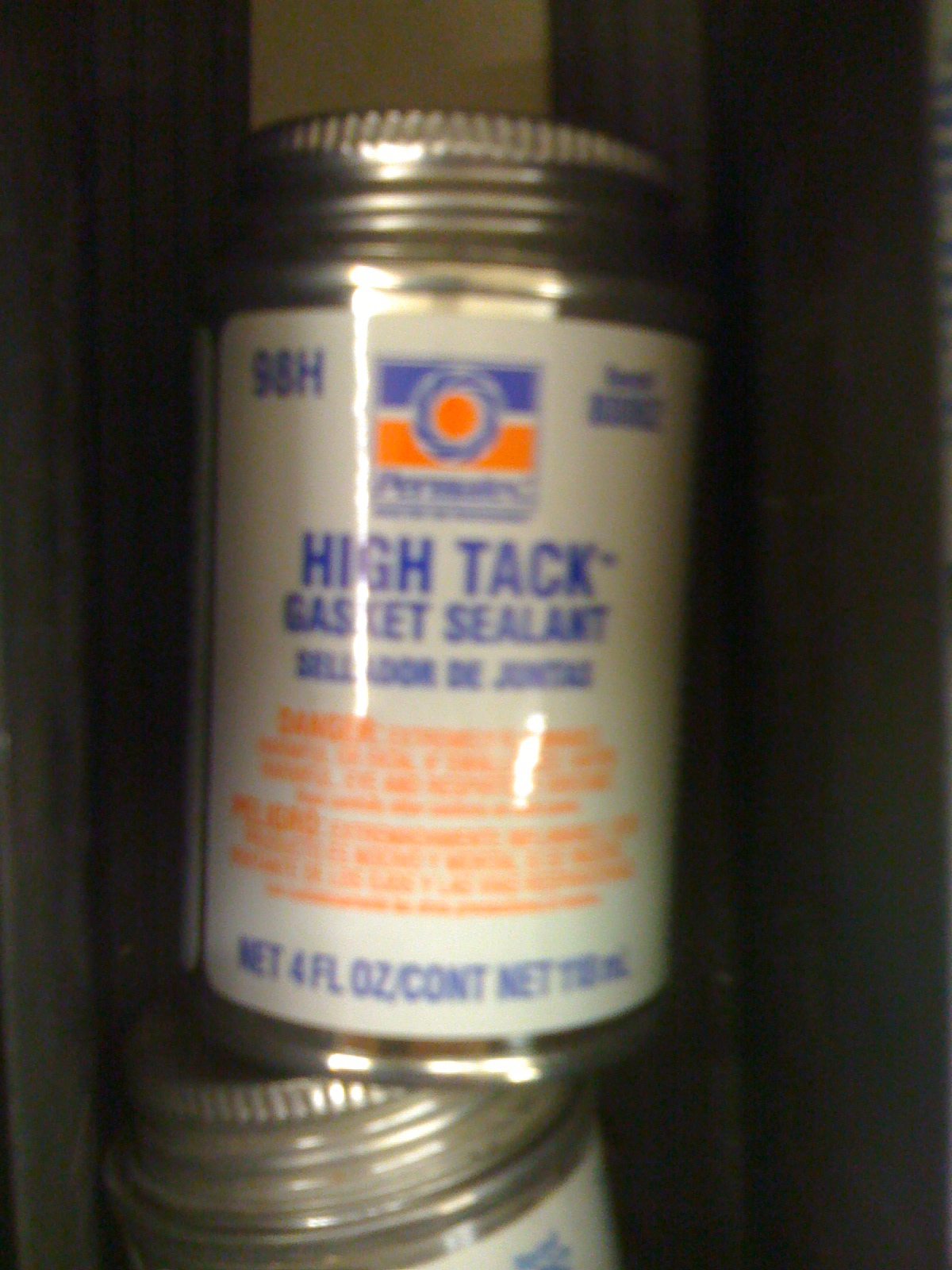

Can I use any of these products or do I need to order something special? I am ready to seal up the rudder.

The pictures are of Permetex gasket products, used in engine assembly.
They're not made to seal up the rudder.
What you need is called 'proseal' and is found here:
http://www.vansaircraft.com/cgi-bin/catalog.cgi?ident=1267916071-182-15&browse=misc&product=proseal.
Same stuff used for the fuel tanks.

I would recommend that you buy a 3 oz kit of the Flame Master tank sealant from Vans for this. It is what they recommend and it will give you some experience using it before you get to your tanks. The sealant will hold the edge of the rudder straight as an arrow and I don't know if what you are looking at would work as well. It is also used building the wings on the trailing edges of the aileron's and flaps.
