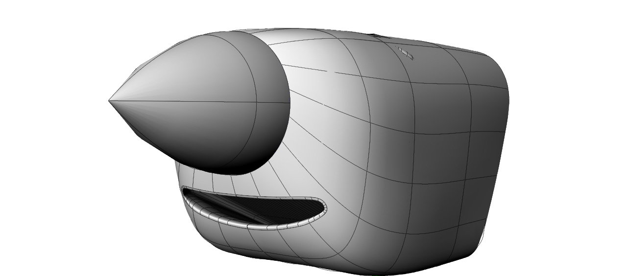

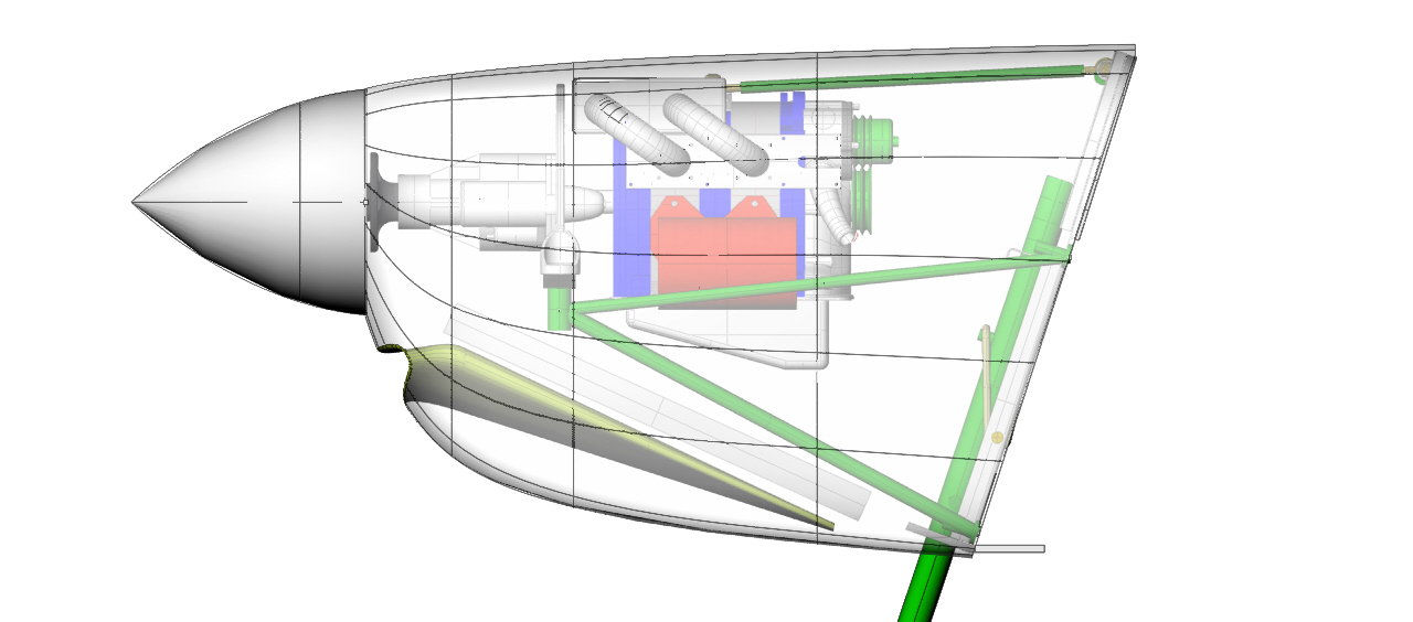

BTW I am working out the issues for my 13b 250 hp rotary engine installation. here are some pics. Lightweight engine, and longer cowl make for a much better look. Kinda P-40ish. We may have to paint on some sharks teeth. Very Happy

See thru profile

Quarter view

That thing looks and sounds great Craig! I'd love to keep up with your progress. I hear rotary engines are more efficient since the parts move continuously instead of stopping and reversing direction. How heavy are we talking? And is this an auto conversion? Fixed pitch or constant speed? Sorry I'm berating you with questions, but you've now tweaked my interest, and I can't stop thinking of the possibilities!
It's not better efficiency, but reliability, fewer moving parts, no valves, significantly higher TBO. BSFC is slightly higher by about 5%, but you can burn auto-gas, big savings.
With lightweight aluminum end housings, I'm figuring installed FWF of 275lbs. That's including rad, cooling and accessories.
Yes.
One can go either route, but my plan is to go with a vari-prop constant speed unit to maximize performance and efficiency.
Of course there is a lot more labor involved, as it is an auto conversion, and requires a lot of custom built stuff. But the results I believe will make up for the expended effort.
