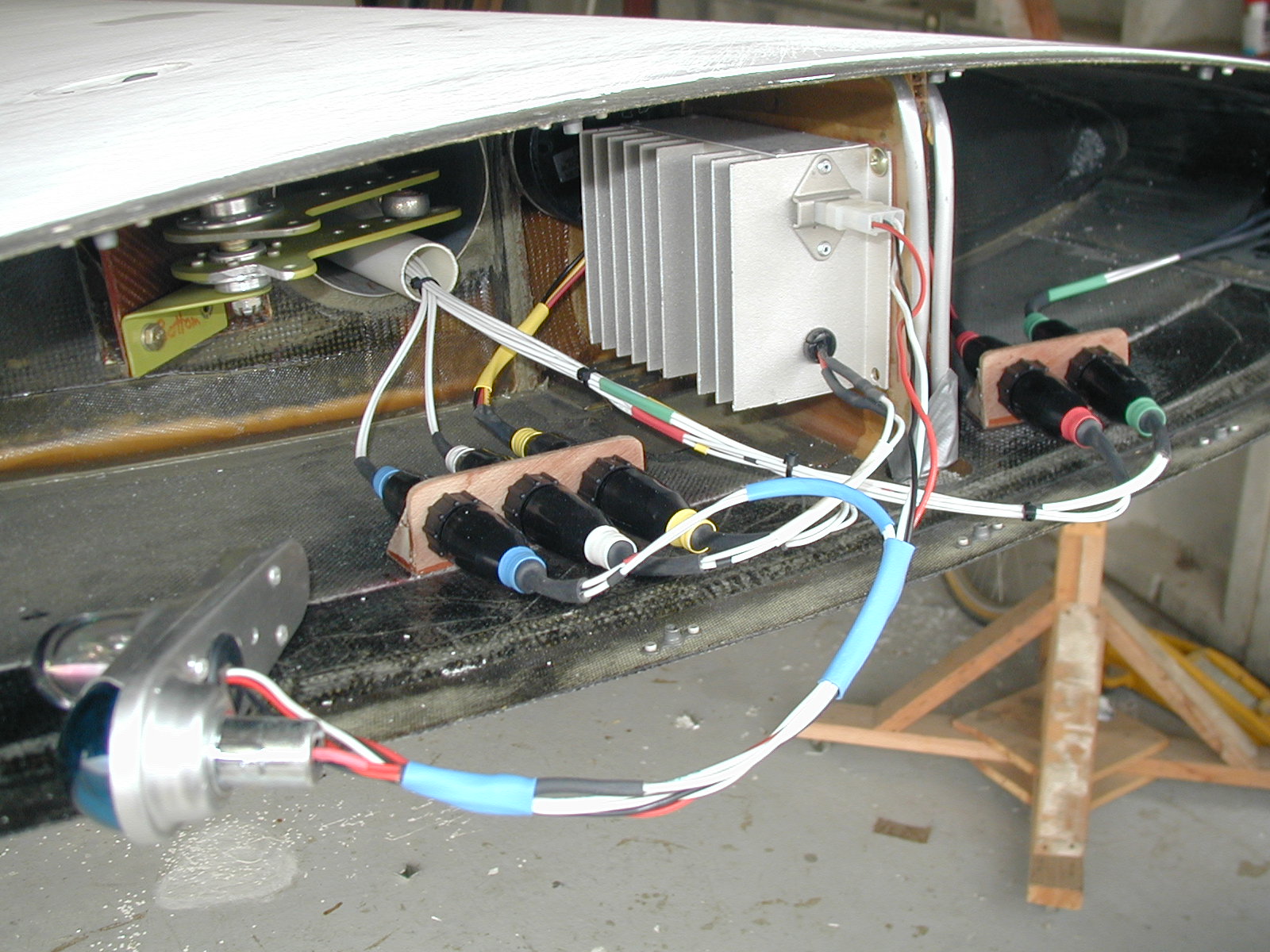

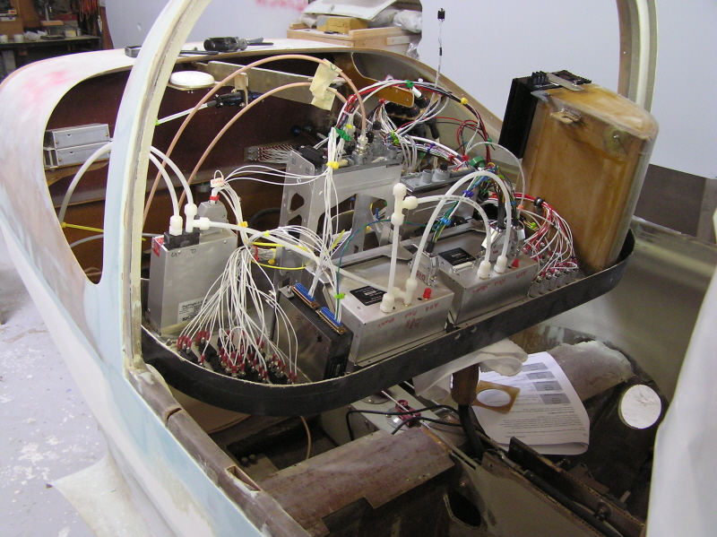

Hi Mike,
I used Amp CPC connectors, series 1. My philosophy was that everything should have a quick disconnect connector on it. Landing lights, fuel senders, trim servos, etc. I also have a 16 pin connector at each wing root and six 16 pin connectors between the instrument panel and fuselage so I can remove the panel easily which I've had to do a lot more times then I ever thought I would. I also put bellcrank bearings on the panel so it can fold down which has made things much, much easier.
www.mouser.com has them. It's a bit hard to find them on the website, but if you click on the catalog tab and look on page 1288 they are there.
I attached a picture of what I did.
For me the electrical stuff seemed overwhelming initailly, but it ended up being the most fun part of the project.
I got pretty much everything electrical from mouser or http://www.bandc.biz/
The military surplus places have great deals on wire sometimes. Don't buy anything electrical from aircraft spruce. They don't even spool the wire.
Cheers,
Scott
