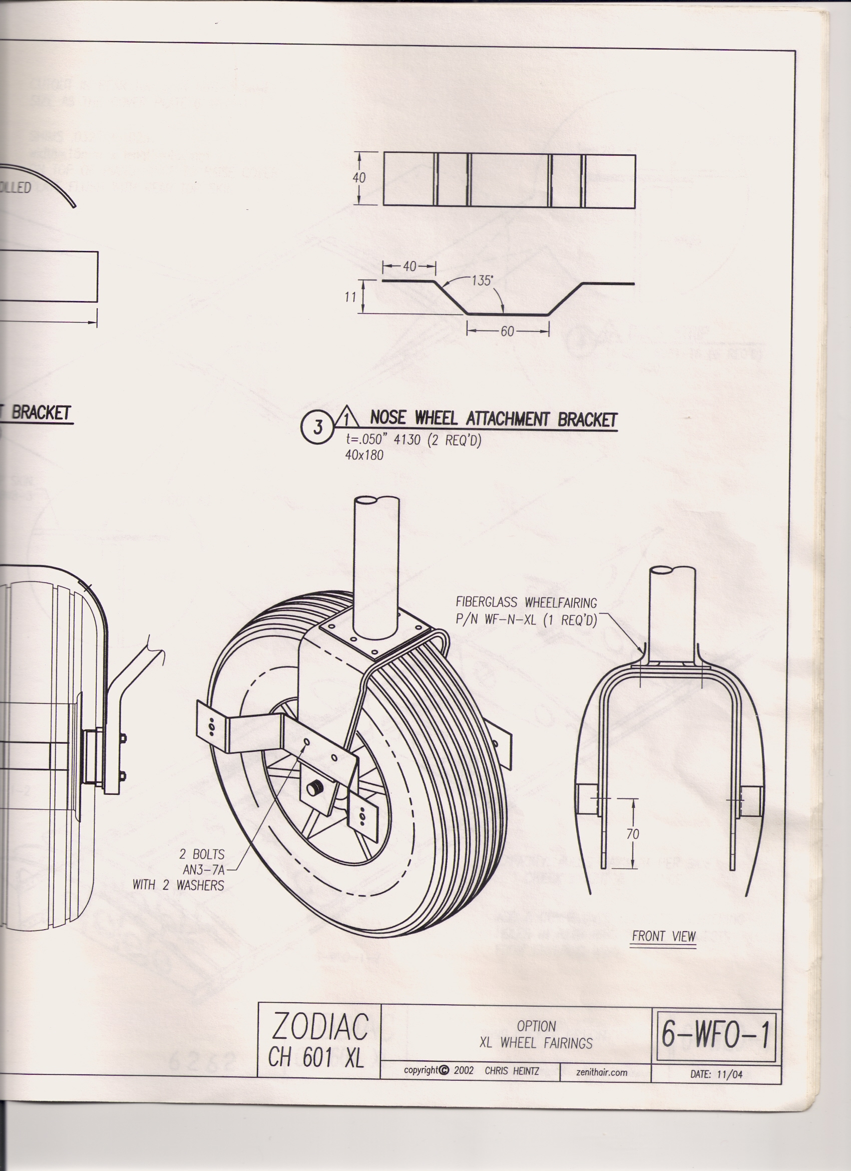

hey I have the 2006 fiberglass nose wheel fairings
I have the photo guides but the WFO-1 plans do not show the size of the sloping Aluminum strip that is riveted to the front portions of the wheel fairing.
Everything else was in the kit but the 2 brackets.. (and they are not on the plans)..
So what size and thickness are they please? and I will make them..
Chris..

PostPosted: Fri Feb 26, 2010 5:43 am    Post subject: XL nose wheel fairing fitment Reply with quote
Chris,
Is this what you are looking for?
Jay Bannister

PostPosted: Fri Feb 26, 2010 2:05 pm    Post subject: Re: XL nose wheel fairing fitment Reply with quote
thanks Jay
I have the plans page . The Plate I am talking about is where the rear part of the fiberglass fairing, is attached to the fwd part of the nose wheel fairing. It has rivets and anchor nuts on it.
what size and thickness and spacing of the anchor nuts..
I cant find it on the plans I do see it on the photo guide but not its dimensions or thickness or where the holes are located..
Thanks. anyone with it measure it please

PostPosted: Fri Feb 26, 2010 2:43 pm    Post subject: XL nose wheel fairing fitment Reply with quote
Chris,
I made mine out of some scrap .025 I had lying around. It fits the whole
length of the cut (minus a few mm each end) and is about 50mm wide in total.
I riveted the plate to the front and has nut plates for the rear half.
Next time out at the hangar (tomorrow) I'll take a picture or two.
