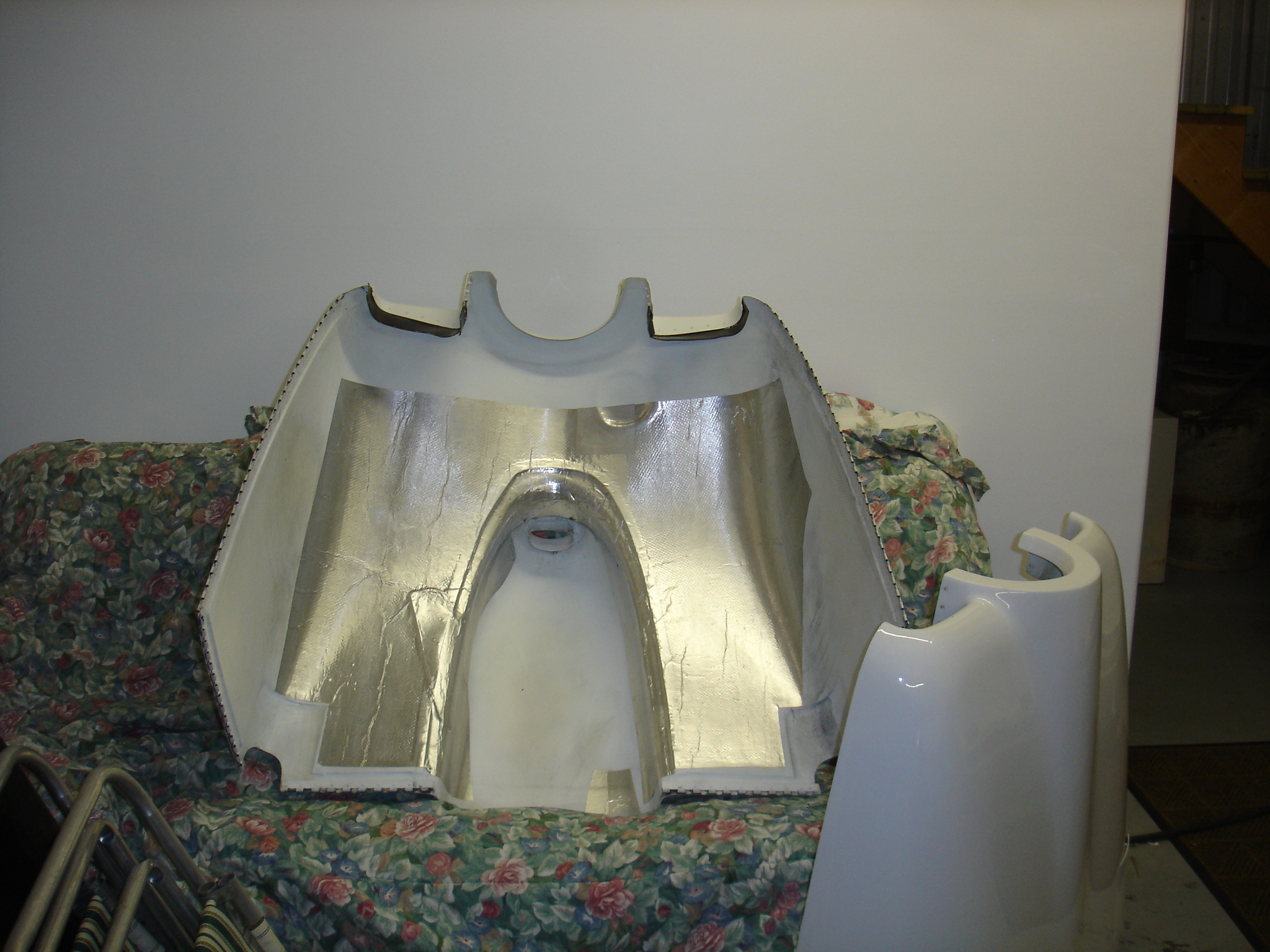

I did the thinned epoxy smear and also made an aluminum heat shield with and air pocket under it for where I felt the exhaust was a bit too close for comfort. I also painted the inside and applied the self adhesive foil for added protection. I have attached a photo.

JohnInReno
Joined: 08 Sep 2007
Posts: 150
PostPosted: Tue Feb 23, 2010 5:53 am    Post subject: Adding Thinned Resin To INSIDE Of Cowling... Reply with quote
Is the self adhesive foil insulated or just reflective?
