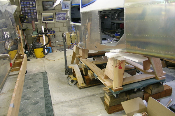

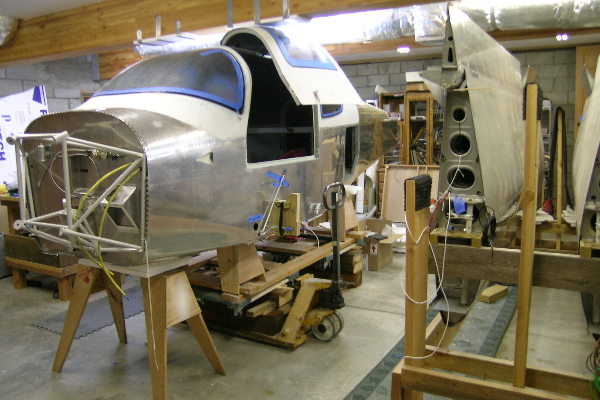

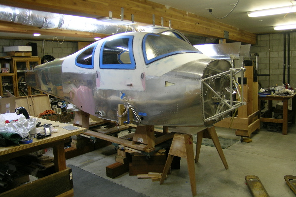

indigoonlatigo(at)msn.com
PostPosted: Thu Feb 25, 2010 6:49 pm    Post subject: Doing the windscreen - any last minutes tips? Reply with quote
Use a floor palate jack, lots of wooden blocks and wooden wedges to fine tune the for leveling. Might only take a few hours...to find, then cut all that wood around the house, and go up and down with the jack trying in different wood pieces until perfect.
Put padded saw horses under it too in the event of an earthquake. That should work unless the entire house falls on it. Ain't building in the basement great.

PostPosted: Thu Feb 25, 2010 7:57 pm    Post subject: Re: Doing the windscreen - any last minutes tips? Reply with quote
Bill,
A less wood-intensive method of supporting the fuselage in the correct position is to C-clamp a 2x4 vertically to each spar stub. Use a bottle jack and short piece of 2x4 under the spar stub to raise each side to the proper height. Reclamp the first 2x4 so it extends to the floor. I replaced the rear tie down ring with a bolt, then used a tripod stand to hold the tail at the correct height to level the longerons fore and aft. Since I had already hung my engine, I also used my engine lift with a nylon strap around the upper motor mount tubes to support most of the weight of the fuselage. A laser level that shoots an overhead line is an easy way to establish an accurate centerline the full length of the fuselage, then measure an offset line L and R for each wheel pant.
Jim Berry
40483
N15JB
MauleDriver(at)nc.rr.com
PostPosted: Thu Feb 25, 2010 9:05 pm    Post subject: Doing the windscreen - any last minutes tips? Reply with quote
Jim, it finally dawned on me that jacking the spar stubs was going to be
the key. I have the engine installed and it's sitting on the gear.
But I'm having a hard time visualizing exactly what you are suggesting
for the c-clamped 2x4. Can you elaborate a bit?
Jim Berry

The bottle jack and short 2x4 go under the spar stubs, and are used to tweak the fuselage level side-to-side. The longer 2x4s are clamped to the aft sides of the spar stubs to help maintain the level position. It needs to be long enough to reach from the top of the spar to the floor. I used 2 C clamps per side. I jacked the spars just enough to get the main tires about 1/4" off the ground, then raised the low side a little more to bring the fuselage level. The C clamped 2x4s did a good job of maintaining that position, and showed no tendency to walk. Once you have it leveled side-to-side it is easy to tweak the engine hoist and/or tail support to get level fore and aft.
The other thing that really helped in getting the wheel pants in position was to make 2 L-shaped jigs to hold the wheel pant level fore and aft. Basically just 2 plywood supports with one leg on the floor and the other leg perpendicular to the floor. After you establish the fore and aft level line on each wheel pant(use a laser level) you can measure the height from that line to the ground. Drill a #40 hole in the nose and tail of each pant on the level line. Drill a hole in each jig the same distance from the floor, and pin each jig to the pant with a finishing nail. You now have a way to hold the pant level and at the correct height. By moving the jigs around you have a stable way to position the pant relative to the tire and mounting bracket. Have fun.
Jim Berry

Jim, just wanted to say Thanks for the detail on the jacking. I never
would have tried the C-clamp thing on my own but it works great. Engine
hoist on the engine mount (engine on), an oak 1.5x1.5 c-clamped to each
spar, a camera tripod doing nothing back at the tail.
The first pant is going on fine - might try the 2 ply supports but not
having any problems there yet. I just got a laser line thingy - very
cool. $30 at Sears for a 1 line device with detachable magnetic mount.
Couldn't imagine exactly how to use it despite all the mentions of it's
use on this list. Fool around with it for 10 minutes and it starts to
seem indispensible. The centerline of the aircraft thing is a piece of
cake.
Jim Berry
