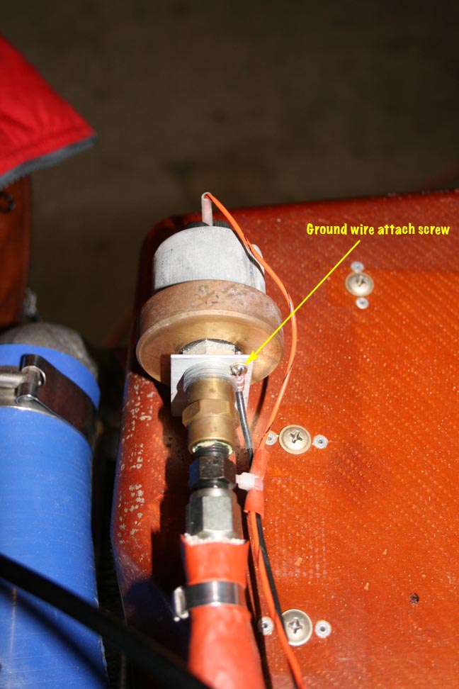

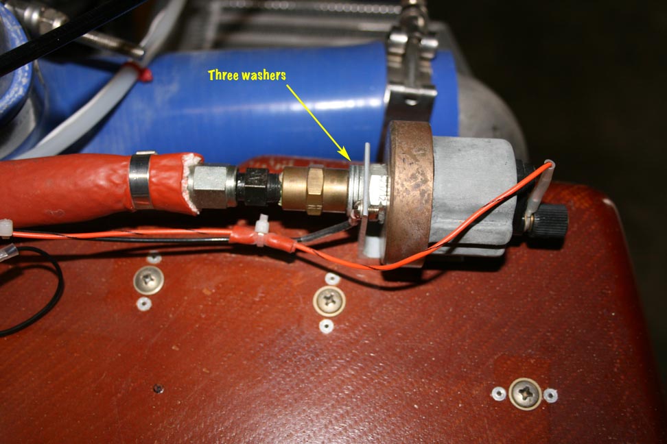

PostPosted: Sun Feb 21, 2010 1:02 pm    Post subject: How to ground rempte mounted VDO oil pressure gauge. Reply with quote
Hi Ron,
I took some pics of the remote oil pressure sender yesterday while I was doing the firewall aft part of the annual.
Perhaps they will help:
[img]cid:DB16B534-486A-4AFE-A8BF-83A2F608ACAB[/img]
BTW, that's not a third black wire, it's a shadow of the signal wire.
[img]cid:23F30C2C-F6F1-41E0-8D0E-C98D6E5FB8A1[/img]
The three washers provide a nice tight clamping of the sensor and still allow the NPT threads of coupling to seal properly.
I hope this helps.
Bob Borger
