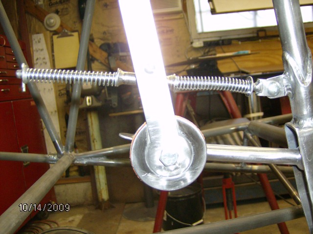

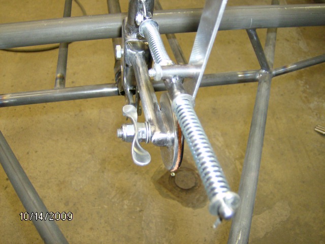

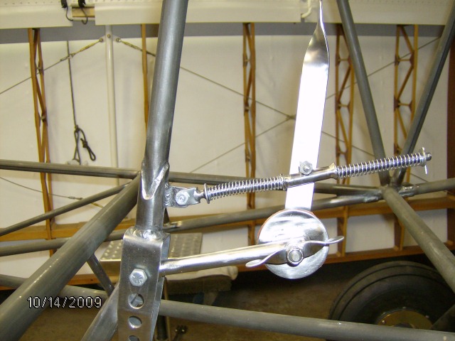

Wittman had a simple trim system that works...
Here's some pictures of mine... I can give you more details if you need them.
Gotta Fly...
Mike & "Jaz"
Building Wittman "Buttercup" w/Lycoming 0-235

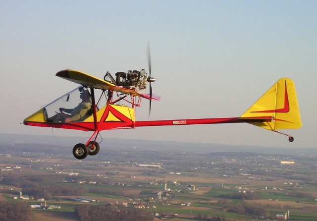

PostPosted: Tue Feb 16, 2010 1:56 pm    Post subject: Re: In flight Adjustable Trim Reply with quote
Ellery,
My experience at pitch trimming the kolb plane using adjustable horizontal stabilizers has been totally unsatisfactory. I believe the reason for this is because of the specific triangular shape of stab which reduces the surface area of the stab to near zero at the outer point of the stab.
On my plane I needed more nose up trim, so I tried lowering the leading edge of the stab. The result was totally unsatisfactory. It merely made the elevator have a natural downward deflection to remain aligned with the air flow as it passed over the stab. It actually now required even more back stick pressure to keep the nose up and it was less efficient because the stab and the elevator were now misaligned with a combined camber that is opposite what is necessary for the downward direction of the force on the tail to raise the nose.
I attached an in-flight picture where you can see this opposite camber of the stab & elevator necessary to produce downward force of the tail.
Against all intuition I then raised the leading edge of the horizontal stab to align with the natural inflight position of elevator and much to my amazement it improved the trim greatly.
I did eventually add an in-flight adjustable tab to the elevator which is much more effective and efficient at aerodynamically changing pitch trim, though I'm not saying it is better than adjustable spring tension to the mechanical linkage of the stock kolb elevator.
My conclusion is that trying to use adjustable stab incidence for pitch control on a Kolb is ineffective and a wast of time and effort.
Merely sharing my experience.
Gene Z
