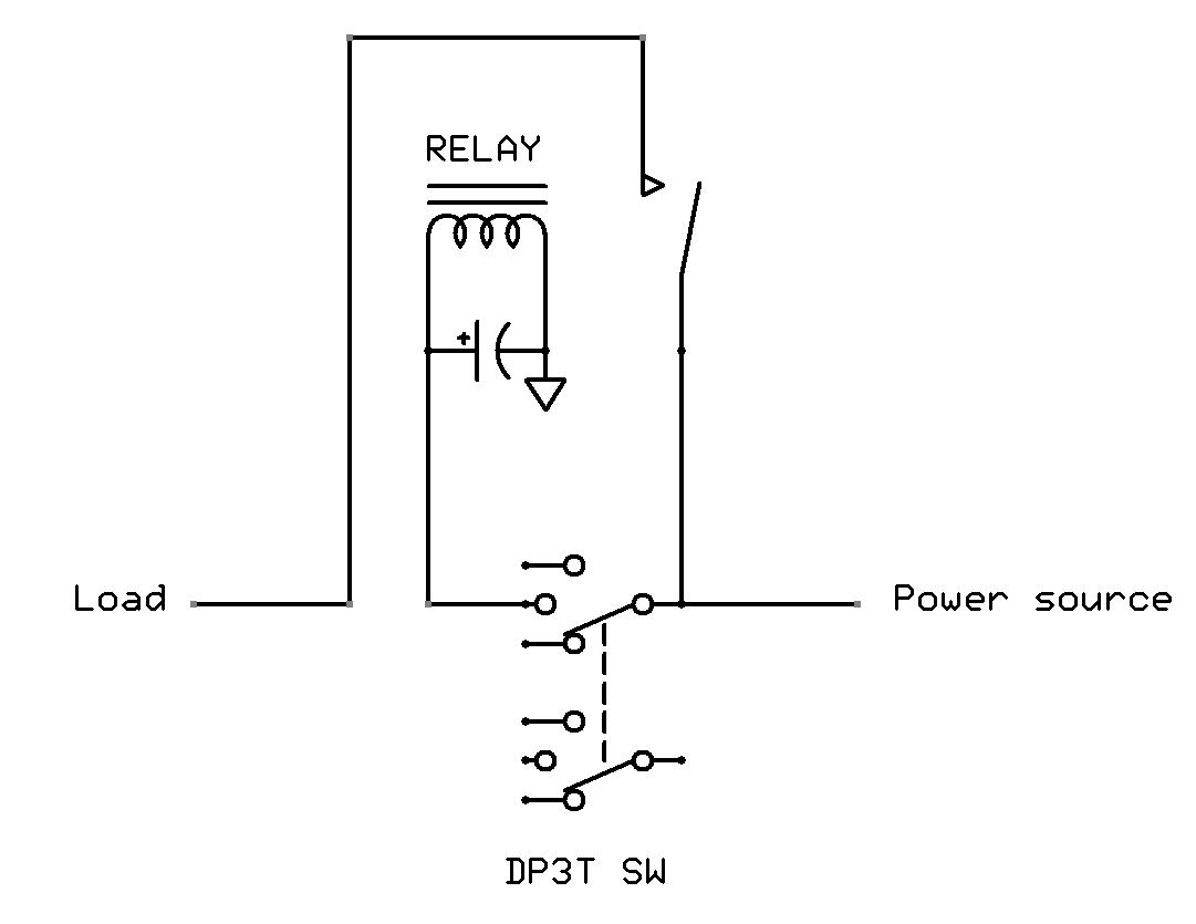

Perhaps additional components can be used to delay opening of the DP3T switch contacts while switching from one position to another. A large capacitor might help, depending on the current of the load. Or a relay can be used with its contacts in parallel with the DP3T contacts. See the attached sketch. http://tinyurl.com/ya5zkkv
If you post a copy of your schematic, others can offer suggestions.
