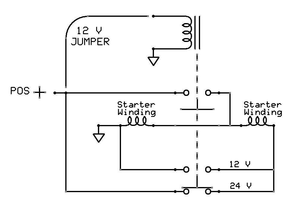

See: http://www.skytecair.com/Jumper101.htm
Quoting from Sky Tec's website:
Sky-Tec repurposed the S-Terminal functionality on NL model starters to serve as a means of switching the starter between 12V and 24V operation. Because of this, ALL NL STARTER INSTALLATIONS MUST BE WIRED ACCORDING TO THE CERTIFIED AIRCRAFT WIRING DIAGRAM BELOW - NO EXCEPTIONS!
See wiring diagram: http://www.skytecair.com/images/NL%2012V%20Installation%20Wiring_1100.jpg
Evidently the jumper changes the internal wiring to the motor. If operated on 12 volts without the jumper, something bad might happen.
Joe

PostPosted: Fri Feb 05, 2010 9:23 am    Post subject: Re: Starter and contactor wiring Reply with quote
You got me. Never heard of the 12/24 volt jumper option.
If the starter will function when supplied with 24v
and the "S" terminal left open, then there's something
going on inside that I'm not aware of. Suggest you
follow instructions and leave the jumper installed.
Could there be something like this inside of the starter?
http://tinyurl.com/yallsk4
The manufacturer is pretty adamant about installing that jumper for 12 volts. It seems to me that wiring according to Van's diagram would work too, as long as 12 volts gets applied to that starter jumper-terminal while cranking.
Joe

PostPosted: Fri Feb 05, 2010 12:07 pm    Post subject: Starter and contactor wiring Reply with quote
At 11:23 AM 2/5/2010, you wrote:
--> AeroElectric-List message posted by: "user9253" <fran4sew(at)banyanol.com>

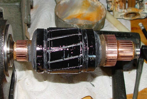

Interesting! It's not clear to me how the pair
of starter windings are managed . . . the PM
starters I'm familiar with have windings only on
an armature accessed through brushes. and commutators.
To accomplish what's depicted would take a dual winding
armature with two sets of brushes on each end of the
winding stack. I've seen armatures like this . . .
usually on dynamotors of the 1940-1960 era.
[img]cid:.0[/img]
Here's an example of a 3-winding armature for a 24v motor,
and two high voltage generators all on the same piece of
moving machinery! I suppose one could do a 2-voltage
starter with two 12 windings on one armature. It would have
to be more complex than the drawing suggests.
If you look at electron flow in the 24v mode, both coils
run left to right. In the 12v mode, the left coil is
left to right, the right coil is right to left . . . they
would oppose each other unless the brush wiring to one
of the windings is also reversed.
Seems mighty complex just to get a "universal" starter.
That's the way I see it too.
