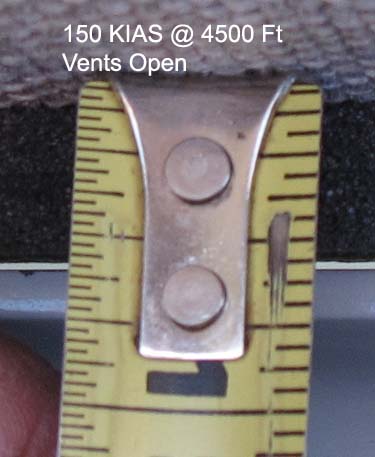

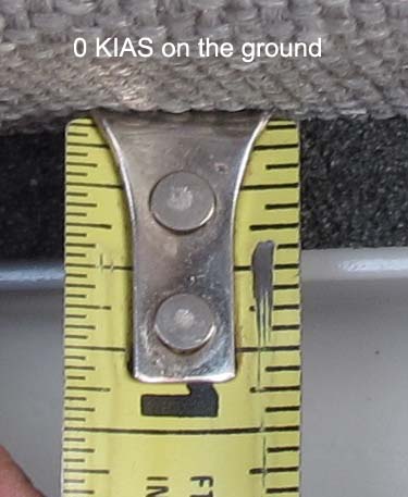

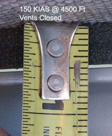

PostPosted: Thu Jan 28, 2010 7:38 pm    Post subject: Re: Door Flex Reply with quote
Tim Olson wrote:
I'm intrigued by the reports of "bowing". I've never noticed mine bowing at all, and they don't flex, either.
I never thought mine bowed either, but last week I took a short flight and took some pictures of my door.
The pictures are of the door measured at the middle fore-aft about at the back of your hip. One picture of the door is on the ground. The second is with all my vents closed flying at 150 KIAS and a 3rd is with all my vents open flying at 150 KIAS, both at 4500 Ft.
It looks like with the vents CLOSED, I have 1/16 inch bow and at 150 KIAS with all my vents OPEN and freezing my self to death, I have 1/8 inch bow. I have the Rivet Head Aluminum pins/blocks and it is a tight fit on the ground when closing the doors.
At 150 KIAS, all vents open

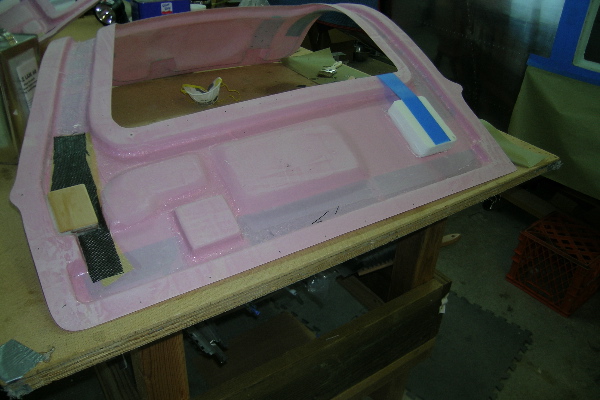

PostPosted: Thu Jan 28, 2010 8:42 pm    Post subject: Door Flex Reply with quote
Now that is good science...Good work.
Thats why I put a spider foam block laminated between the door halves in the area shown. It acts like a shear web between the skins. There is a lot of open air space in that location of the door.

John I like the idea of adding some substance to the door in there but forgive me but what is a spider foam block?
