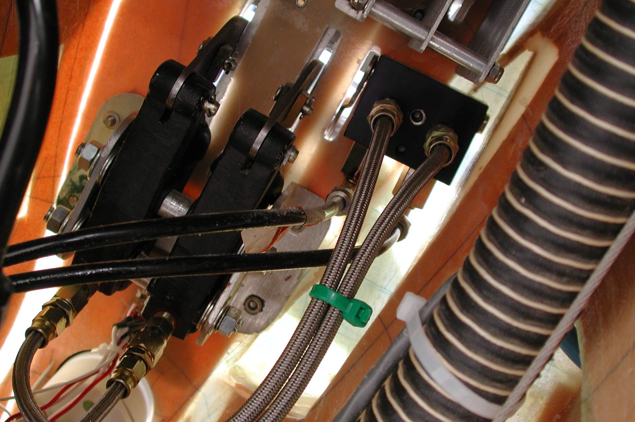

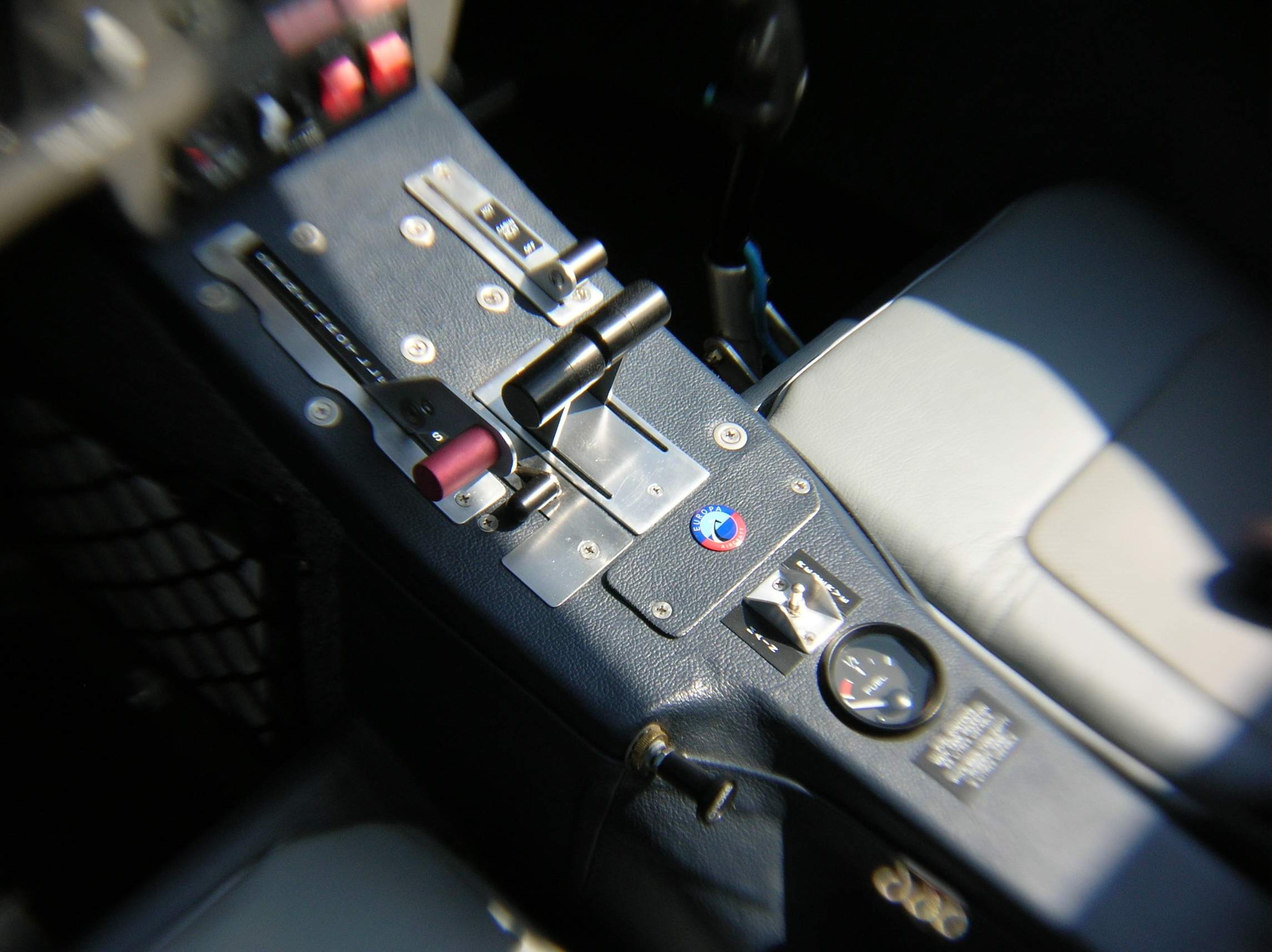

PostPosted: Mon Jan 25, 2010 11:50 am    Post subject: Finger Brakes Reply with quote
David Hi!
I fitted the original Matco Foot Brake cylinders to Trigear G-FIZY I built. I fabricated a bracket, ensured there was a removable panel above the bleed screws and it worked well. My only recommendation would be to ensure levers are long enough, probably about 9” but just as important is to ensure knob or handle ends are big enough for a good grip or action. There was a requirement to ensure correct rubber seals were used for different brake fluids. I used the ‘red’ Dot 5....I think! Europa supplied the rubbers. Photos attached. The Brake Levers in photo proved too short (action difficult) so were extended by about 4”.
Gerry
Gerry Holland
07808 402404
[url=gholland(at)content-stream.co.uk]gholland(at)content-stream.co.uk[/url]
Based at White Ox Mead, Near Bath
PostPosted: Mon Jan 25, 2010 11:54 am    Post subject: Finger Brakes Reply with quote
David Hi!
Gerry
Gerry Holland
07808 402404

PostPosted: Mon Jan 25, 2010 5:45 pm    Post subject: Finger Brakes Reply with quote
gerry,
is that a parking brake valve you have there, mounted next to the cylinders, if so would you mind sharing the source,
Like you i used the matco cylinders and the original mounts inverted and mounted in the tunnel. I then added another bracket
to either side to take the throttle and IFA levers.
craig

PostPosted: Mon Jan 25, 2010 9:29 pm    Post subject: Finger Brakes Reply with quote
Craig Hi!
That is a Parking Brake fitted beside the two Brake Levers.
The idea was to allow one handed ON or Off operation. When the levers were short it worked OK but once they were extended the reach required from one hand didn’t allow it. The Park Brake Unit was a 06-17200-MATCO BRAKE PARKING VALVE-$113.95 from Aircraft Spruce.
The Hand operated Brakes take a little getting used to initially but after a short time it works out. The brake discs seem to need to be worn in pretty well as well.
After that you can establish safe taxi speed and use the rudder for many fine adjustments in direction.
