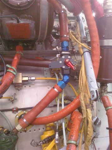

I agree with the oil shutoff. I have the manual valve from Kimball Enterprises, it has the extra value of a switch that you can tie to your starter button. If the oil is STILL shutoff, you cannot start.. I have proven this is important.. J
http://www.jimkimballenterprises.com/web/m14p.php
Does not matter who , just get one in my opinion..

Look at item M14P-6 - http://www.jimkimballenterprises.com/web/m14p.php Dave Jester recently installed the Kimball system on his 52TD. He might have some pictures of the installation.

Here are some photos of my installation on a Yak 52 TW
http://picasaweb.google.com/dmcgirt/OilShutoffYak52TW#

Dennis is correct, partially. I used Kimball cutoff valve but had an aviation grade pump built for the sump. I have pictures and will post them when I can recover them from a computer in my hanger. When I have my valve closed, the air start button will not operate because of a micro switch set up. The only way it the prop will turn is if the oil shut off valve is open engaging the micro switch. I have seen Girt's photos and my set up is a bit different. Works nicely and reduces the oil from leaking out the exhaust, etc. I notice little if any oil on my belly after a flight now. Oil loss/consumption is down as well. Girt, how you doing?

The TW does not seem to have the same layout in some regards, so we had to make some interesting bends.. but I burn less than a quart an hour flying hard acro these days.. so I am pretty happy with the whole setup.. I plan on replacing the scavenger hose with something a little more rugged, but quite frankly, it works great.. lol

Yak 52 oil shut off
