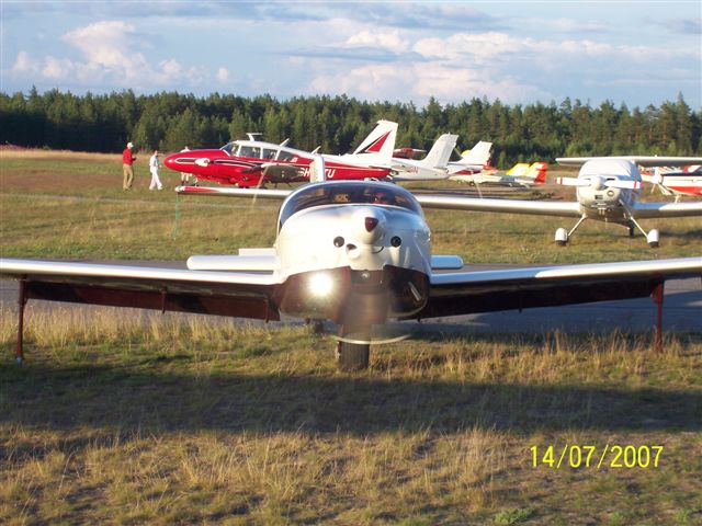

raimo.toivio(at)rwm.fi
PostPosted: Thu Jan 21, 2010 9:49 am    Post subject: Landing and Taxi Light Question? Reply with quote
Hi Jeff,
I feel not to be a Guru but I am brave enough to answer:
I have two 35 W Xenon lights. RT´s taxi light is hidden in the lower cowl turbo air intake (I have 912S so the intake is not necessary for my engine). It is ON in the attached photo. RT´s landing light is built-in to the duct above the air cooler´s air intake. It is OFF but visible in the attached photo. Both are very effective and I have been happy with them all night long. Typical GA landing light 100 W like in Cessna is a children´s torch when compared with these Xenons. An extra benefit: they does not care off vibration or so and their expected life span is around +1000 hrs. They are also light weight. Today you can find even 500 Watts leds and their size is like a mail stamp. But a cooling is a huge (power led´s cooler is huge!) problem.
Raimo OH-XRT
