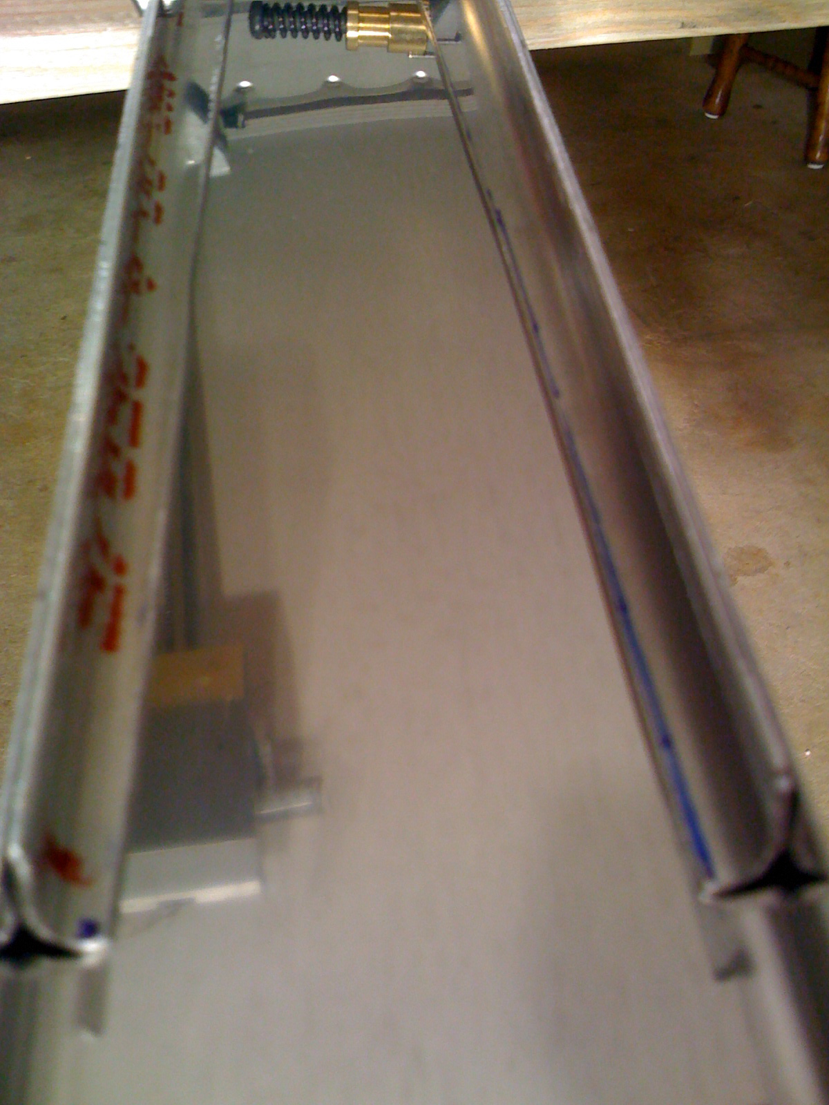

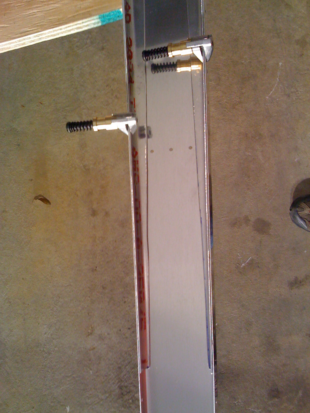

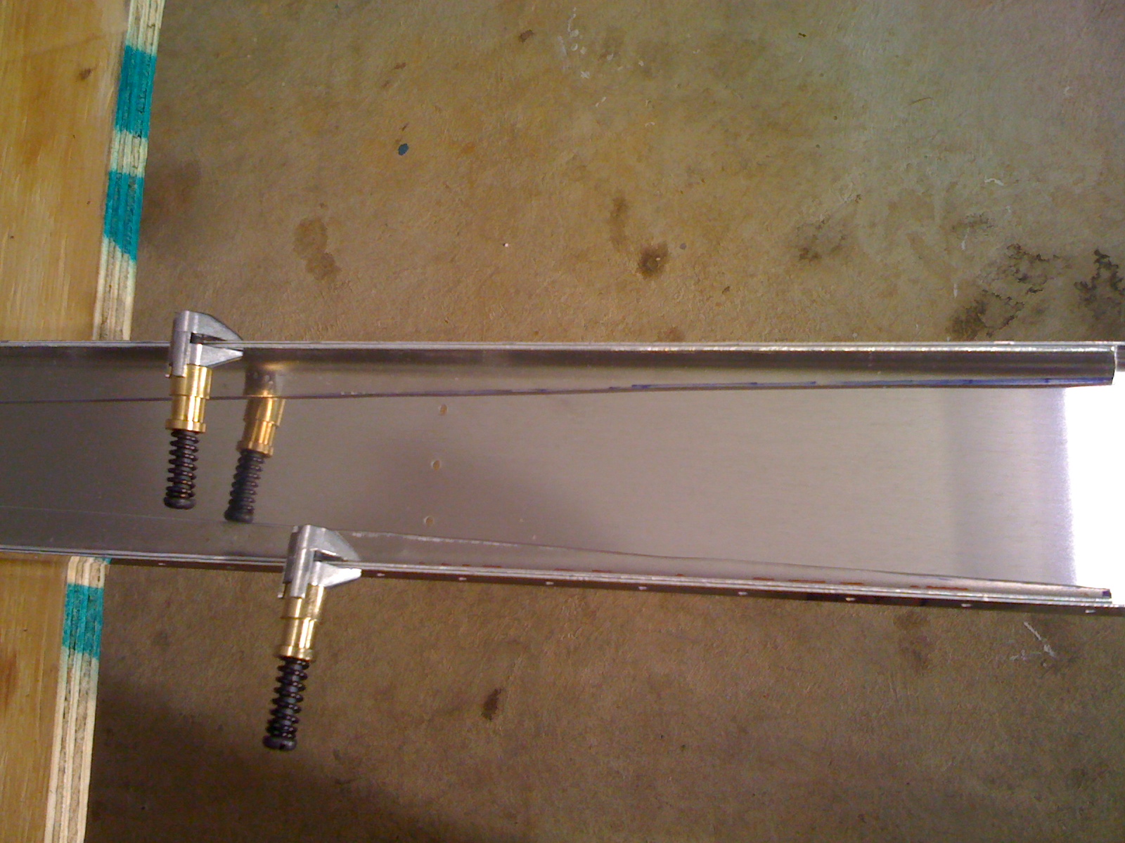

I clamped, marked, and cut the rear spar caps outside of my line using a band saw.
My cuts had a couple of gradual waves in them. I worked them out with an air belt sander and file by clamping the two pieces back to back to try to get them even.
It is not that big of a deal other than I would like to get as much insight as possible while starting out. The cut is not perfect, but will it be ok? Please see attached images.
Also, my air belt sander uses 60 to 120 grit belts. Is this fine enough for deburring aluminum?

The cuts are probably straight enough, but 60 and 120 grit is not
fine enough to do good deburring. Run those pieces over a
scotchbrite wheel until you see no nicks at all. They will
look mirror smooth.

Follow up your sanding with a pass of the Scotchbrite wheel. It will get you a nice smooth finish. I wouldn't worry too much about your cut.

Looks good. Just finish them off with a scotchbrite wheel.
I use a 1" wheel  on a die grinder. Works great on those edges.

Jake those look just fine. You will find you will get the cut and finish
next to the fine line skills will come back fast. Kind of like coloring
book skills as a kid. What helps me get a nice straight edge is I use a 12
in disk sander that is mounted on my shop smith. With the table 90 degrees
to the sanding disk I get a nice clean straight and square edge on material
I am trying to make.
