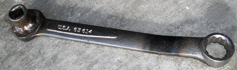

Can you weld a socket onto a wrench, put a torque wrench on the socket end? Of course you'll have to measure the extension and do the math to get the torque multiplication figured out and lower torque reading to use.
Attached is a wrench I used to torque the cylinder bolts on my Honda CR250 motocross bike.

I guess I'll have to weld it on a open end wrench, it seems to be the only thing that fits it , but the math may be a problem?
