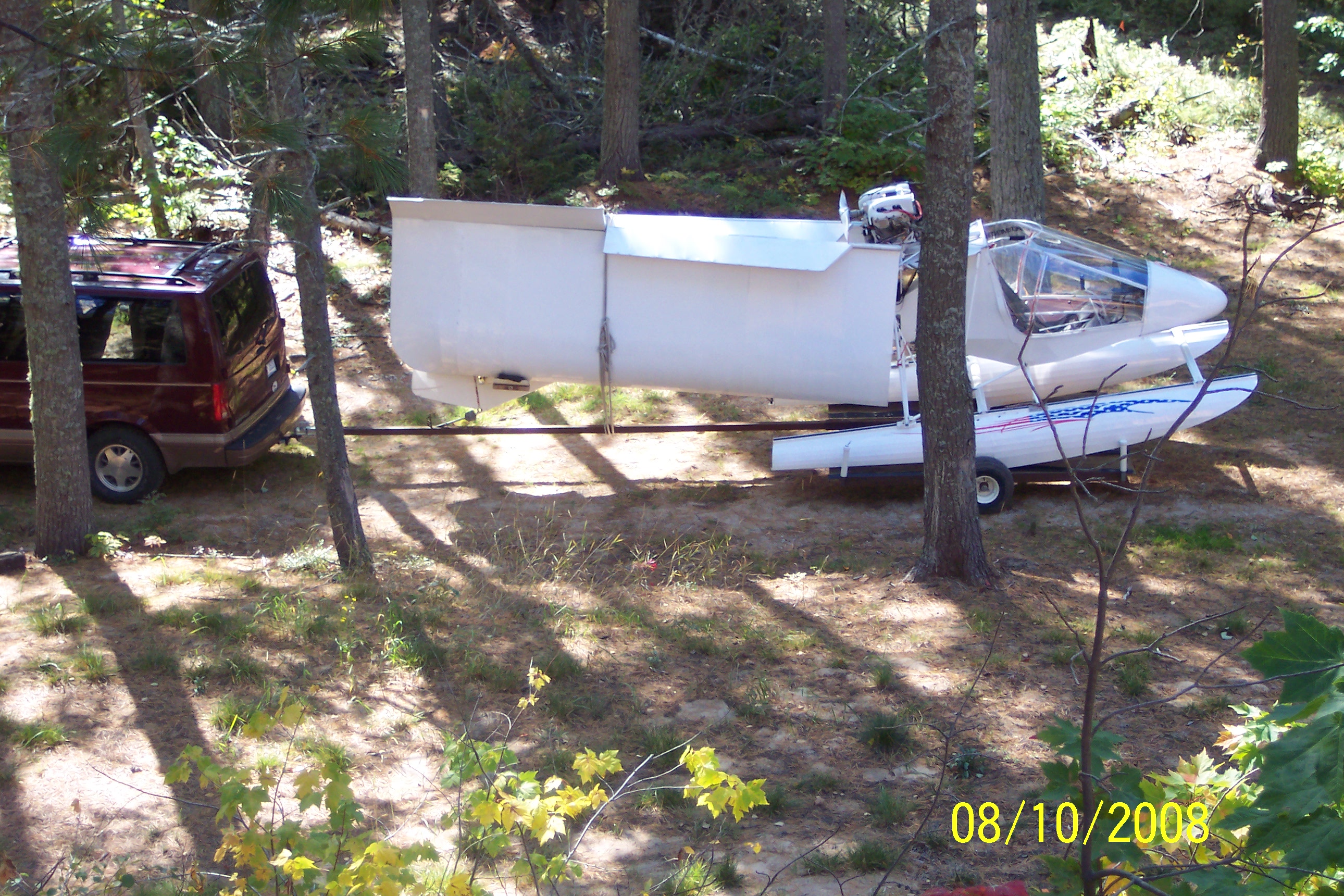

  I should be getting back to work fairly soon on my MkIII.  I think I could finish it in about two months.
  Once my plane is finished C I have a trailer dilemma.  Here's the story;
  I live 1200 feet from my local airport.  Less than a 1/4 mile.  This airport is at the end of my street C and I'm the third house from the end.
There is almost no traffic on my street.  I can go hours between seeing vehicles.
  I plan on keeping my wings and tailfeathers in flight position all the time...that is C I do NOT plan to fold the wings C since I have my 40 x 48 hangar I built last year (on my property).
  I only have ONE obstacle between my hangar and the taxiways...the airport entrance gate.  It's a set of swinging gates C that are always open.  The gap is around 20-22 feet wide and the gate posts are around 9 feet tall.  Simply put C I need to get my assembled plane from my hangar to inside the airport.
  I am looking for trailer ideas.
A)  I plan on towing this trailer with my ATV.
B)  The trailer does not need to EVER be towed on the roads (except for my road).
C)  The MkIII must clear the 9' X 20' gate opening
D)  I can use the 12 volt electrical supply from the ATV (for a winch C etc)
  My initial thoughts are to build a very wide U-shaped frame unit with a towbar.  The plane would roll into this "U" shape gap C and a movable scissor mechanism would rise to lift the plane slightly
by the wing strut attach points (or by the axle legs).
  I could tow the plane about 6" of the ground C and when necessary C raise it 10' briefly to get through the gate opening.
  Any engineering type guys have any thoughts C ideas C suggestions??  I know I can build a very workable trailer C but I am always open to ideas I may not have thought of.
Waddayathink??

PostPosted: Mon Jan 04, 2010 9:27 am    Post subject: Re: Trailer challenge Reply with quote
Mike Welch wrote:
I live 1200 feet from my local airport.� Less than a 1/4 mile.� This airport is at the end of my street C and I'm the third house from the end.
Some Wise Guy is going to say...... "1200 feet approach to the gate?..... fly it over!"
Otherwise.... if you are talking about hoisting the plane high enough to clear the 9' posts, I wouldn't be crazy about doing that. I would rather keep it close to the ground. Tow it to the gate. With a well designed, good wheeled dolly of some design, wing first through the gate by hand. "K" turn it through the gate if necessary.
How much longer is your plane (nose to tail) than the gate is wide? Can't be much. And what, if any, obstacles are on either side of the gate opening. Do/can the gates swing all the way back against the fence?
Lots of planes go through hangar doors that are narrower than the wing spread.

PostPosted: Mon Jan 04, 2010 9:53 am    Post subject: Trailer challenge Reply with quote
Mike- Since the gate is always open, have you checked to see if one side can be removed- or quick detachable, like a socket in the ground? If the owner is an agreeable type, and you can do it neatly, it may convenience other owners as well.

PostPosted: Mon Jan 04, 2010 10:25 am    Post subject: Trailer challenge Reply with quote
Mike,
Cheaper and simpler than a trailer, might be to offer to rebuild the airport gate so your plane fits through it, at your expense... and then just taxi it from your hangar.
Otherwise, build a trailer to tow the plane sideways, and lift just the tail if necessary to clear the gate.
-Dana

PostPosted: Mon Jan 04, 2010 10:37 am    Post subject: Trailer challenge Reply with quote
Hi George C I'll answer your questions one at a time......
> Some Wise Guy is going to say...... "1200 feet approach to the gate?.... fly it over!"
  Interesting that you said that previous statement.  Last summer C I was standing at the end of my driveway C eyeballing the path of a possible landing on my front yard( while my neighbor mowed his lawn).  The next day C he planted a line of trees along his property line.  Obviously he was thinking "don't get any ideas!!
 > Otherwise.... if you are talking about hoisting the plane high enough to clear the 9' posts C I wouldn't be crazy about doing that. I would rather keep it close to the ground. Tow it to the gate. With a well designed C good wheeled dolly of some design C wing first through the gate by hand. "K" turn it through the gate if necessary.
 See C I knew some sharp guy was going to suggest something I hadn't thought of!  Build a turntable mechanism C or better yet C build the trailer to allow the plane to roll on and off diagonally (providing the plane will pass through diagonally)   Hmmm???  I'll have to make some measurements to see if a diagonal pass will work.
How much longer is your plane (nose to tail) than the gate is wide? Can't be much. And what C if any C obstacles are on either side of the gate opening. Do/can the gates swing all the way back against the fence?
  I measured the gap of the gate last summer C but I can't remember now.  The posts allow for two normal width lanes of traffic to enter the airport C so I'm guessing a gap of around 20 to 22 feet.  I know it is close to these figures C I just can't remember exactly.  My plane is real close to 24 1/2 feet.
  The left gate swings inline with the road C just enough to clear the asphalt.  The other gate swings more out of the way C but not ALL the way.
  Your idea of raising the tail to go through the opening is an idea I pondered awhile back.  This MAY be the best idea C yet.  I haven't "designed" any trailer structure to go this method C but it definitely has merit.
  One thing to consider is whatever I come up with C it has to allow for almost NO "slowdown".  In other words C I can't pull up to the gate C and start farting around with some gizmo that takes a minute or two.  I'll lose friends rapidly if I block the entrance.  I will need to pretty much drive through unimpeded C slowing down for no more than a few seconds.
Worth what you paid for it.......
  Actually C worth more than I paid for it.  Both of your suggestions will get more investigation!   Thanks C George.

NeilsenRM(at)comcast.net
Mike
Forget the trailer spend the money on a wider gate. Offer to pay or do it yourself?????
Also The FAA has recently stated that they want to eliminate through the gate operations at airports. The latest ruling states that any airport that has or will get federal funds must stop allowing airplanes to enter. Can you imagine the government mandating that a persons car must be parked on a expressway to be able to use it. Go figure. You may want to check on this.
Rick Neilsen

mdnanwelch7(at)hotmail.co
PostPosted: Mon Jan 04, 2010 10:39 am    Post subject: Trailer challenge Reply with quote
Hi Bill C
  The airport is a local public (municipal??) airport.  Last summer C 100% of the perimeter fencing C plus this entrance gate were replaced with taller (from 6' to 8') fencing and gate.
  Evidently too many deer were getting in the airport and the management thought it would be a great way to spend some federal money.
  The posts are 6" pipes C set deep into concrete C 9' tall.  I can guarantee the airport people wouldn't even give me the benefit of an answer if I asked to change the posts.
  I could do this type of post relocation....neatly.  It's not far from what I did as a career.
I did the "removable post" thing for getting my truck and tractor(backhoe) into my side yard years ago.
  But these posts are HUGE!!!  I doubt I could pick one up C anymore.  Plus C whatever I come up with must not take more than 10 seconds maximum to get me through.
  No C I'm the only goofball that wants to bring his airplane to an airport through the car entrance.
  Thanks for the reply C though.
PostPosted: Mon Jan 04, 2010 10:52 am    Post subject: Trailer challenge Reply with quote
Hi Dana C
  If I thought the airport types would let me relocate the gate (only one gate would need to be moved) C I'd ask.  But C seeing as how this gate is less than a year old C and built with federal money C I can safely say "don't waste your time" C  to myself.
  Example:  Since this is a county airport C I see a county commision hearing C environmental review C traffic study to determine the community benefit C review process C public hearings C more review process C approval C conditions to approval C permit C soils report C engineering review C insurance policy C post a construction bond C  do the work C reinspection.
  In the meantime C I died of old age.  : (
  I think I'll go out to my hangar C and take some measurements.  Plus C I'll run down to the airport gates and take a new accurate gap reading.
  Yeah C I think you're right.  Either the diagonal method C or the lift a tail method C or a combination of the tow is going to be the way to go.
  Back in a while........

PostPosted: Mon Jan 04, 2010 10:53 am    Post subject: Trailer challenge Reply with quote
Rick C
  The new FAA rule doesn't apply in my case.  The FAA wants to stop AIRPLANES from coming through fences to get to an airport C like at some of those airport communities
where you can taxi from your hangar to the active runway.
  Nope C can't forget the trailer idea.  It's gonna have to be that C but thanks C though.

Hello...
I looked at a M3C last year on floats ,and it had a pretty neat trailer to get it a short way to the water....take a look and imagine ! The neat thing about this was the tongue ...it had a hitch on both sides and it slid from one end to the other so he could run it up on the trailer ...pull it up on shore then push the tongue all the way though ...pin it ...tie the tail to the tongue and tow it home....then it's all set to put back in the water !
good luck !
