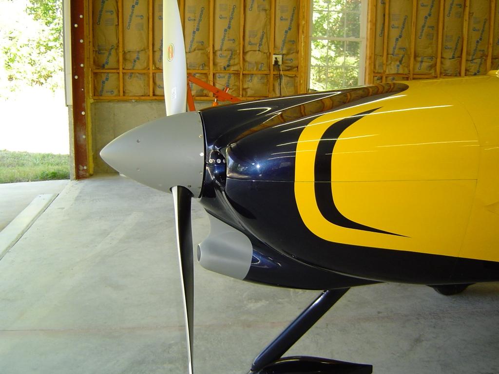

On the 8A I modified the cowl inlet, extending it forward and adding a shark
fin between the inlet and the top of the bottom cowl. The FAB was modified
to accept a 3" SCAT hose. I made and then glassed in a 2" long tube to the
inside of the cowl inlet, the tube diameter such that the 3" hose slides
over it. The hose is attached to the FAB with a hose clamp, and slides on
the outside of the lower cowl tube. As the hose is slightly longer than the
gap between the cowl and the FAB, the hose spring keeps it in place. I'll
do something similar for the 10.
Attached is a photo of the second cowl mod - still in primer gray at that
point. I had to move the intake back 3/4" for prop clearance when I
upgraded to a Hartzell CS prop on the 8A.
Carl
