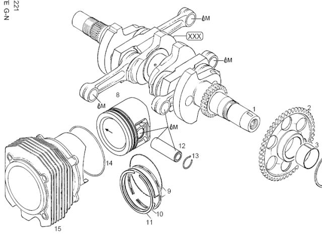

Gilles.Thesee(at)ac-greno
PostPosted: Thu Dec 31, 2009 11:02 am    Post subject: Rotax 914 Won't Start Reply with quote
AmphibFlyer a écrit :
Rotax engines have a flywheel
AmphibFlyer,
Rotax engines have NO flywheel.
(and will run smoothly without a prop)
Running a Rotax without a prop is a no-no.
Season's greetings
Best regards,
Gilles

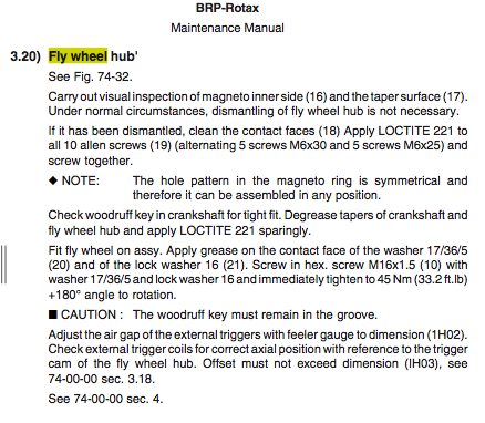

AmphibFlyer
Joined: 29 Dec 2009
Posts: 25
PostPosted: Thu Dec 31, 2009 11:51 am    Post subject: Re: Rotax 914 Won't Start Reply with quote
Gilles.Thesee(at)ac-greno wrote:
Rotax engines have NO flywheel... Running a Rotax without a prop is a no-no.
Well, you're right, mostly. I shouldn't have said that they do. On the other hand, the 912/914 Heavy Maintenance Manual discusses "flywheel hub" in several places (July 01/2008, 74-00-00, page 49, page 117, and page 25). It doesn't seem to show a clear diagram of an actual flywheel, though.
Also I should confess that I have never tried to run a 914 without a prop and relied on someone else's testimony, which I can't verify right now. So maybe it can be done and maybe it can't.

flyadive(at)gmail.com
PostPosted: Thu Dec 31, 2009 12:32 pm    Post subject: Rotax 914 Won't Start Reply with quote
Gilles is right 100%!
You should NEVER run an engine without some form of flywheel.  A prop IS a flywheel.  And if your friend ran an engine without a flywheel and is alive to talk about it he is either lucky or a liar.
An engine run without a flywheel or the proper size flywheel can JUMP into a RUNAWAY condition and reach RPM's so high the engine will literally tear itself apart / explode.
Another question to throw into the pot:  Is the prop properly CLOCKED?  If it is not in the correct position you will get rough running and vibration.

[quote]--> RotaxEngines-List message posted by: "AmphibFlyer" <SeaRey(at)AbstractConcreteWorks.com>
Well, you're right, mostly. I shouldn't have said that they do.  On the other hand, the Heavy Maintenance Manual discusses "flywheel hub" in several places (July 01/2008, 74-00-00, page 49, page 117, and page 25). It doesn't seem to show a clear diagram of an actual flywheel, though.
http://forums.matronics.com/viewtopic.php?p=279458#279458

On Thu, Dec 31, 2009 at 1:51 PM, AmphibFlyer <SeaRey(at)abstractconcreteworks.com (SeaRey(at)abstractconcreteworks.com)> wrote:

PostPosted: Thu Dec 31, 2009 12:54 pm    Post subject: Rotax 914 Won't Start Reply with quote
Barry, Rotax engines run a gearbox of either 2.27 or 2.43 ratio. How exactly are you going to CLOCK it?
Rick Girard
On Thu, Dec 31, 2009 at 2:32 PM, FLYaDIVE <flyadive(at)gmail.com (flyadive(at)gmail.com)> wrote:
