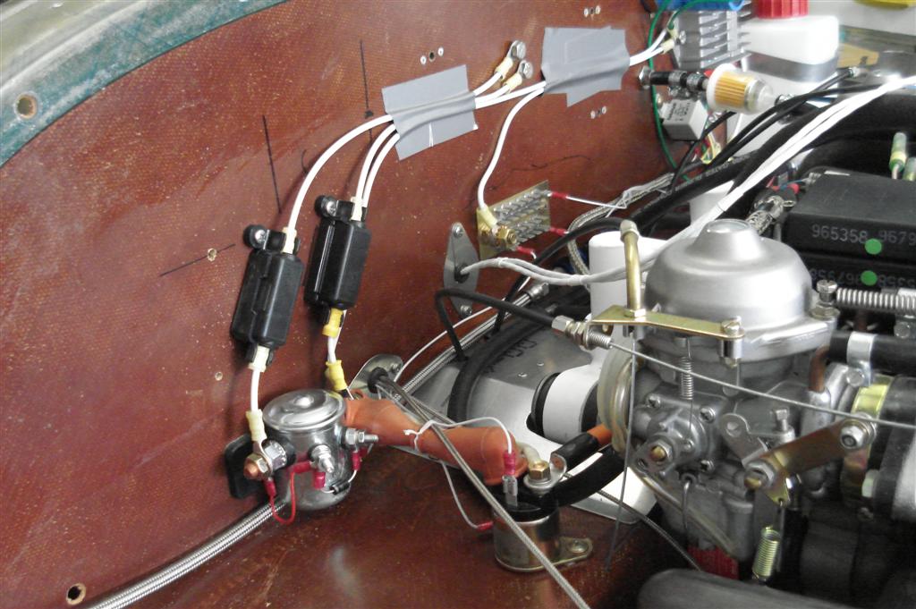

PostPosted: Wed Dec 23, 2009 8:21 pm    Post subject: 30A slo-blo fuse Reply with quote
Another quite elegant solution is strip fuses available from Vehicle Wiring Products (UK)
See attached, the black things above the Master Solenoid.
Kingsley
