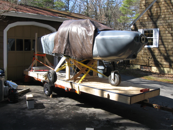

The wheels are 7 feet apart so you would need a 8 foot wide trailer to just wheel it on.
I did the same thing using a 4 foot wide 16 foot long trailer but the wheels were hanging over the sides. I supported the fuselage from under the mains, with extra support for the tail end. I attached a picture of this unlikely combination but I didn't get the feeling that it is really being passed through.
