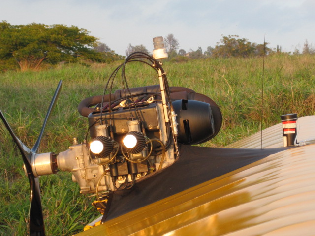

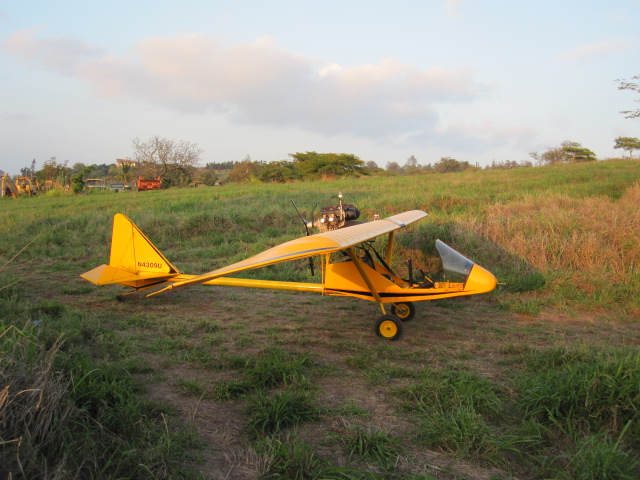

Thank you all for your comments and observations on 503 running temperatures.
Since first running the 503 on FireStar 2 cht has been too cold. The result has been too fast build up of carbon in rings, piston, and head.
The problem has been solved by installing a fairing in front of the fan intake.
Warm holiday wishes to all,
Dave
