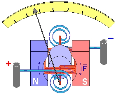

Hence, the market is small. We do offer a customized
kit for the installation of load meters on one
or dual alternator systems. These use the simple,
stable, accurate metallic shunts and simple, low
cost, pivot and jewel, d'Arsonval meters . . .
[img]cid:.0[/img]
See:
https://matronics.com/aeroelectric/Catalog/AEC/9007/9007.html
This approach proved the most elegant for ruggedness,
stability of calibration and cost of ownership when
the builder desires a panel display of current.
