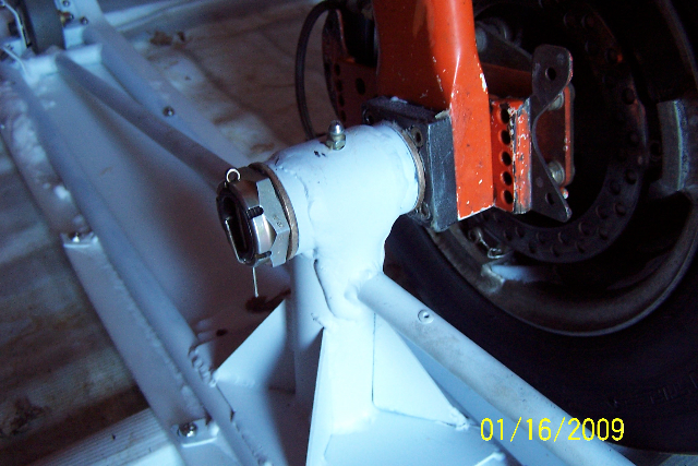

Can anyone tell me if the axle shafts for the model 1-4 bungee gear are all the same?
Thanks.

Measure one. I think they all 3/4 " -- Length will vary a bit on each one but likely mostly the same. I have used 4130 tube. 2 or 3 pieces that sleeve inside each other on a 440 lbs plane -- it been going for 15 years like that and never bent.

From the factory, all axles were the same. 3/4 inch solid stock. The
manual gave a method of drilling out the inner portion for weight reduction.
My first Model IV was solid, the first owner of my present project had them
drilled.
My impression is that they were of mild steel as when tweeking the alignment
of the first Kitfox, it was the axles that bent rather than the landing
gear.
Lowell Fitt

You can use 3/4" hollow axles that are 1 3/8 "s longer and offerd for sale by a guy on the west coast. I think it is Brian Tracy. I have bush gear and let them stick out inside. I wish they were longer. I plan on mounting skis on them after I lengthen them. I think they were only $35 a pair with axle nuts.

My axles...when I had the standard bungee gear...were mild steel. I
very easily drilled mine out with a 7/16" drill of the correct
length, Lowell.

Pat, have you thought about using that protruding stub for a
centering stub, and make longer ski mounts with an inner diameter of
3/4"? The axles that I made for my skis are tubular, 1-1/4" OD, .156"
wall, and .938" ID. You could bush the inner diameter down to your
3/4" stub.
I welded my 1-1/4" ski mounts to a square of 1/2" thick chrome-moly,
after boring a 1-1/4" hole in the center and vee-ing the joint area
before welding. I chose this size ski "axle" because of the 1-1/4"
axle nuts that Spruce sells.

Lynn, I was planning on extending the 1 3/8' stub  7/8" with a 3/4 to 1/2" steel reducer bushing to accomadate a 3/4" x 2" long bronze oilite bushing. I am going to run a 1/2" steel rod inside the hollow axle and reducer retained by the axle retaining bolt. I'll hold the oilite bushing on with a washer on the axle and a cotter pin or retaining clip. I hope the assembly will be strong enough with that 1/2"  mild steel rod down the center. I'll only be extending by 7/8". If the axle would have been 7/8" or 1" longer it would have been perfect..

I ordered some .750" 4130 .250" wall thickness and took it over to a buddy of mine to have the ends threaded for the nut. I left a few inches sticking out on the inside of each axle so I can get the jack on it for doing wheel to ski swaps. I have bent the solid axles, but have not yet bent the hollow axles. Hollow is actually stronger and less prone to bending than the solid ones so my engineer buddies say.
EDIT... yes, they are the same unless someone has modified them. They should all be .750" axles.

Just be sure the ski axle is long enough to counteract the forces
that will be exerted on it by those frozen ruts acting on the ski
itself. Three feet or so of leverage (half-length of ski) acting on a
2" long axle can produce quite a force. I tend to overbuild maybe,
but better that than some wreckage.

I like the idea of the 4130 tubing for the axles, but I have found in
several applications using 4130 that the tubing outside diameter is always
several thousands over an exact .750". That is after using the correct size
reamer in the reciever tube.
I have tried to get it inside .750 ID bearings - no go. and this is a
constant with smaller diameters as well - at least the tubing from ACS.
What did you do to get it in the landing gear? Did your friend also machine
the OD to .750?
I just checked my reamer and a piece of .750" stock and the reamer checked
out at .750 and the tube at .755.
Lowell

chucked it in the lathe, then used a machine file very lightly to get the .750 OD. Could have just turned it on the lathe but the file was alot quicker.

Adjustable reamer?

Lynn, Thanks for advice. Wouldn't a shorter axle be less tortional force on the axle? It would require the mount to be heavier in the axle area but have less force on the axle perpendicular to the axle than a longer one. I like to over build too. You guys can buy those 3/4" 4130  hollow axles from Brian Tracy in Oregon for $35 a pair with axle nuts. At least I think the name is Brian Tracy. Thats where I got mine. They are 1 3/8" longer than the original KF axles.

A shorter "ski axle" would be less torsional force on the "wheel
axle", I believe. But I was referring to what the ski will do to the
"ski axle" if the ski axle isn't strong enough. A ski caught in a
frozen rut will try to twist, wrench, and otherwise mess with what it
is attached to...and the first thing it's attached to in your plan is
the "ski axle." I bolt my ski axle onto the inside/backside of the
Grove gear, using the 4 bolts that attach the Grove axle.
Lynn Matteson
Jabiru 2200, #2062, 824.8 hrs
Countdown to 1000 hrs~178 to go
Sensenich 62"x46" Wood prop
Rotec TBI-40 injection
Status: flying (and learning)
Pat Reilly

Lynn, Agreed. That's why I said the ski mount would need to be built heavy. We are on the same page. Thanks for the picture.
Pat Reilly

Lynn, Thanks again. We are on the same page, but after looking at your photo I realize I will have to plate my tubes to reinforce them to distribute the tortional forces along the 2" long ski axle so as to not apply all that force only where the tubes join the axle. The ski axle in your photo has another one on the other side. Mine will not. Damn, I guess what I really need to do is find out if I can buy 3 1/2" longer axles from Tracy O'Brien. And, make my ski axle 4" long.
KF's NOTE I PREVIOUSLY STATED YOU COULD BUY 3/4" x 10" LONG HOLLOW CROMEMOLY AXLES FROM BRIAN TRACY. I SHOULD HAVE SAID TRACY O'BRIEN. TRACY HAS A WEBSITE with the axles, brakes, etc..  BRIAN TRACY has a website also. BUT, HE IS A SALES TRAINER. Sorry about my dislexia. As a young girl cashier once told me, "It's not dislexic being easy you know".
