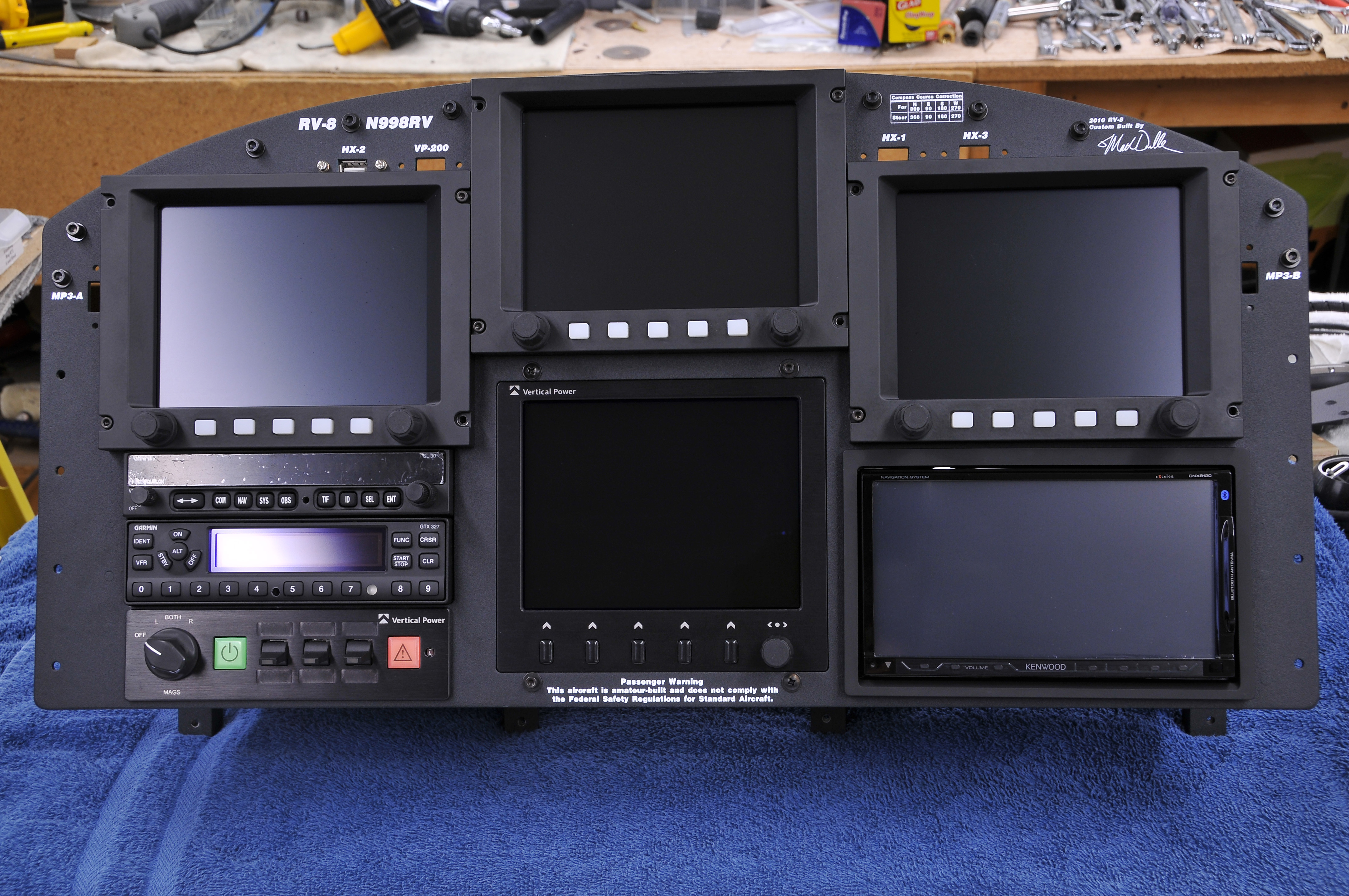

Matt,
Your panel looks super. However, I can only read, maybe, the N
number. Is there a way for you to post a larger photo of your panel
so I can see more in detail how your powder coated panel labels read
and look.
And exactly how were the labels done? We are just about to have our
panel powder coated and labeled. Boy, is it difficult to figure out
the wording for each switch, etc.
Dee

Here is the full-resolution shot of the panel. I used a textured power coat that looks really nice. Same as I used on the engine baffles. The silk screen looks okay. In retrospect, I think that I would have power coated the panel gloss black, did the silk screen, then had them put a clear texture power coat over the top.
For the right side control panel, I'm having them use a "label" the full size of the panel. The stuff looks just like the power coated panel in both texture and color. The lettering, however is super crisp. I'll post some pictures when I get it back. I also had them make up some similar labels for the various remote controls like the Alternate Air and Cabin Heat.

Quick question Matt....did you have that thing powder coated in a flat/matte
finish?
