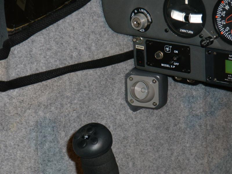

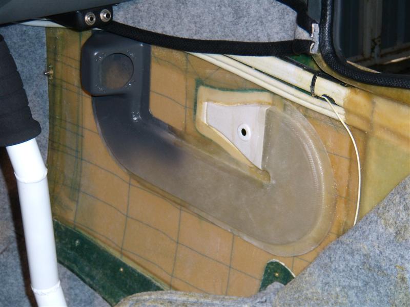

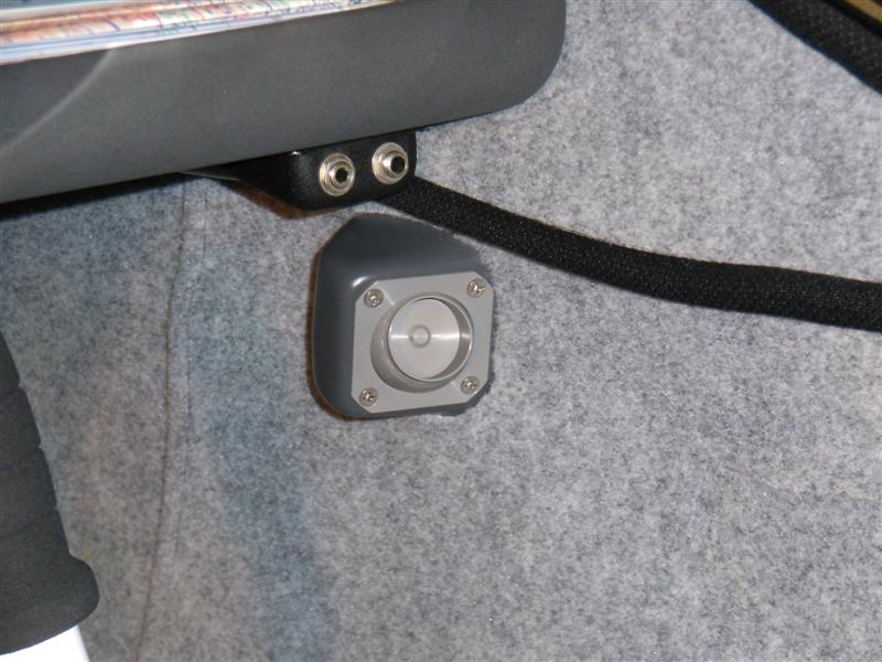

In my opinion the supplied NACA are very effective to cool the pilot left and passenger's right knees only. After living with that inconvenience for 7 years and 600 flight hours, I decided to fix it. I made a fiberglass conduit which is glued in place and allows the fresh air from the NACA to be rerouted forward to an aluminum eyeball vent. The original Naca shutoff panel has been removed. The conduit is hidden behind the sidewall carpeting. See attached pictures. Now I can direct fresh air were I want it. The pilot side vent has been tested for one year now and the pax side was installed last october. Both are very effective.
Remi Guerner

I'm happy with the ultimate vents I placed above the knee, so they are just clear of the instrument module. Seems like the lightest and easiest to install of just about any of the ideas out there.
Kevin
